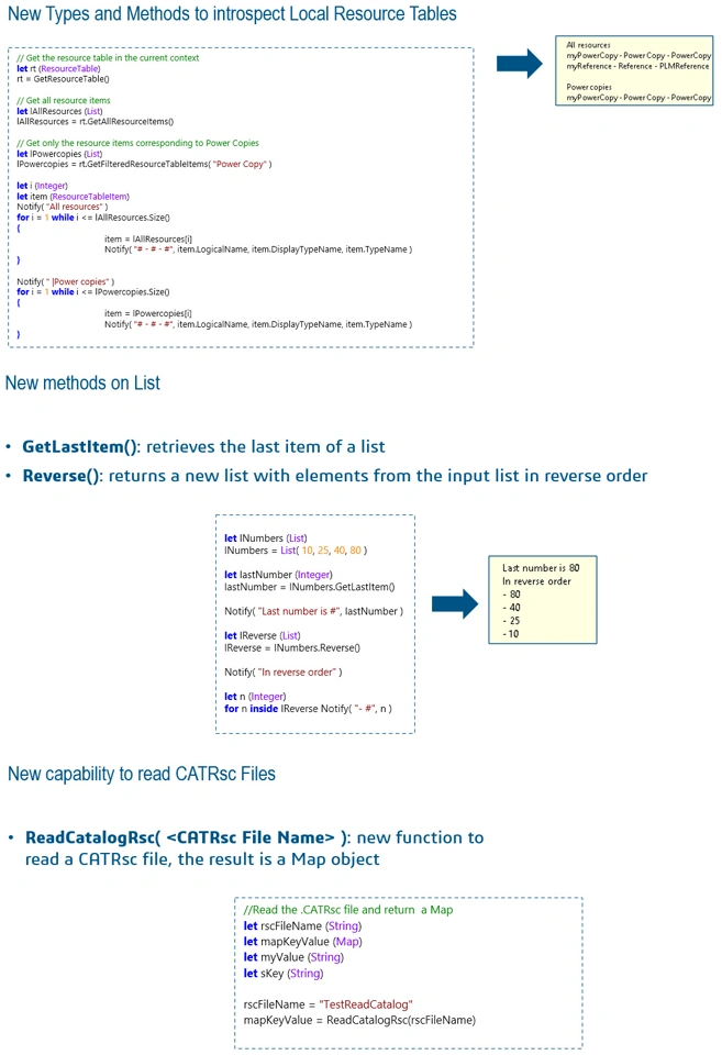

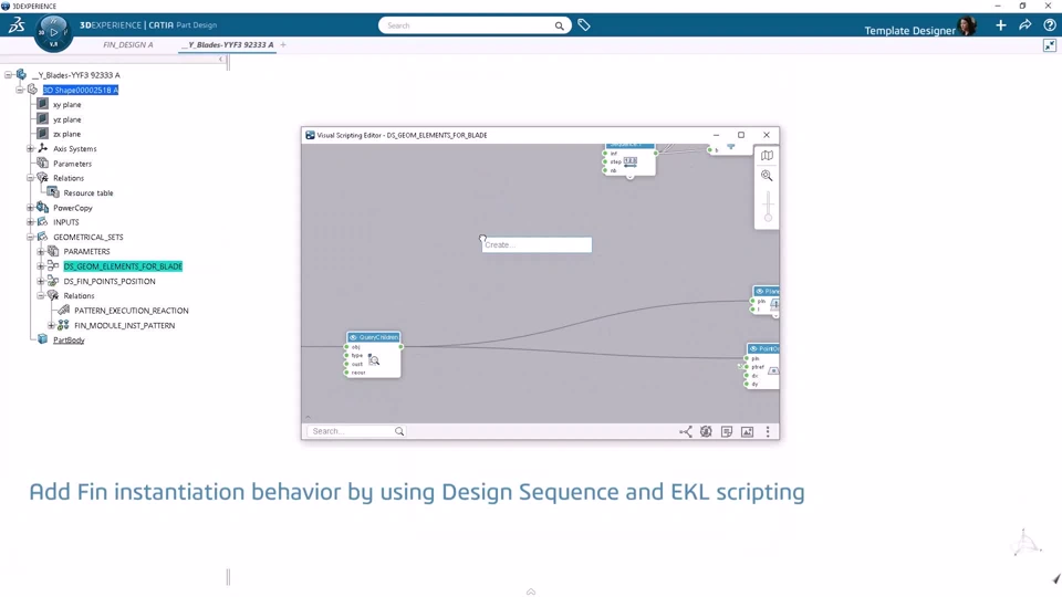

- Improve scripting experience with new Enterprise Knowledge Language functions and methods in various core domains
