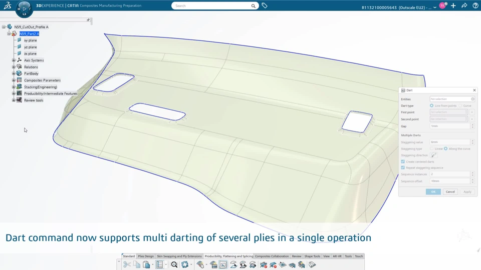

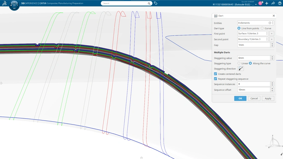

1. The Dart command now support multi darting: several plies can be cut at the same time and a staggering can be applied to the dart position in order to avoid ply chimney effect

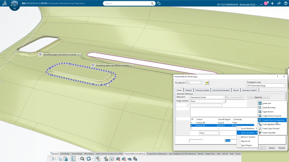

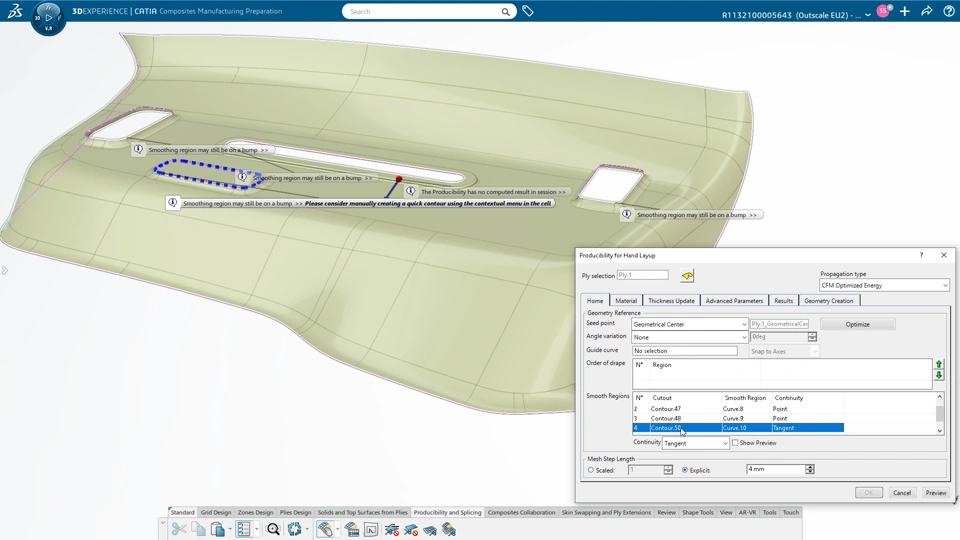

2. The producibility analysis now automatically accounts for cut-out in the plies by generating the corresponding Smooth regions, or propose a quick way to design the curves to be used as input of the Smooth region
Create manual smooth regions quickly with enhanced geometry creation tools
