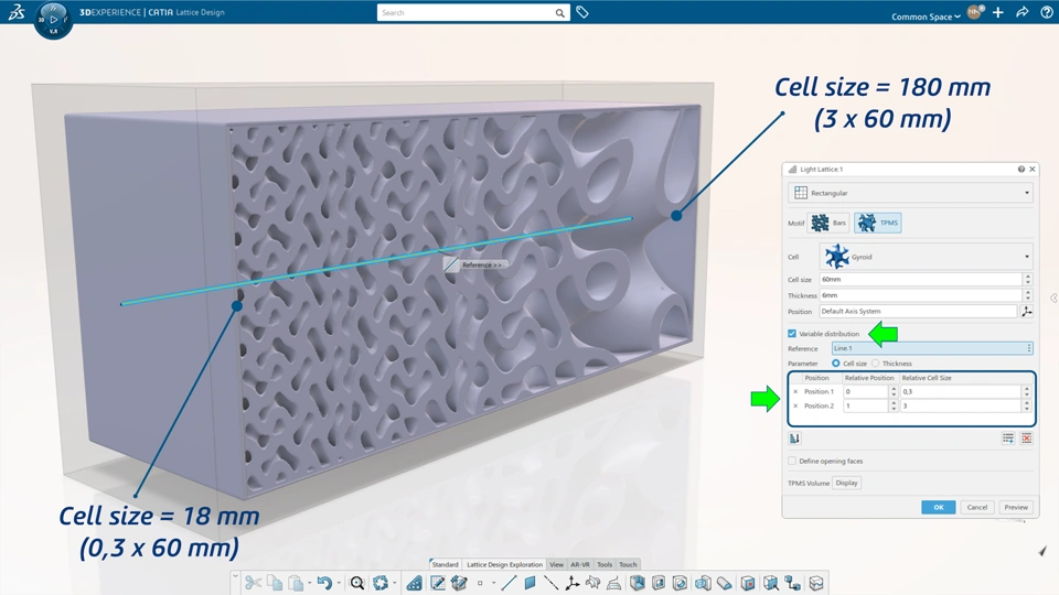

The picture shows a variation of the size of a Gyroid unit cell size along the curve highlighted in light blue. The Relative Cell Size ratios are applied to the Cell Size at the extremities of the Reference (Line.1). The thickness of the Gyroid remains constant.

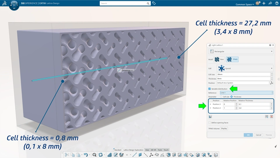

The picture shows a variation of the size of a Gyroid unit cell thickness along the curve highlighted in light blue. The Relative Thickness ratios are applied to the Cell Thickness at the extremities of the Reference (Line.1). The cell size remains constant.

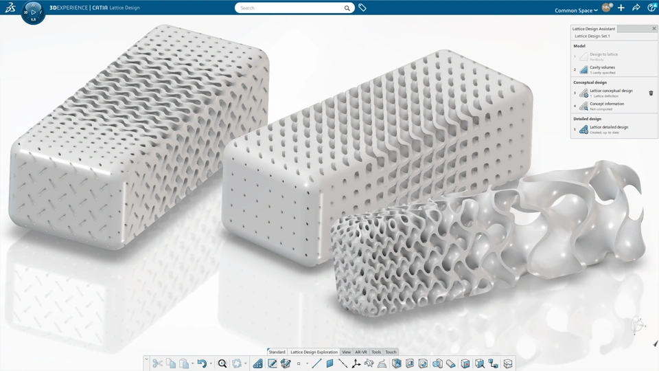

From Left to Right: Cell Thickness variation of a Gyroid Lattice, Cell Thickness variation of a Diamond Lattice, Cell Size variation of Gyroid lattice

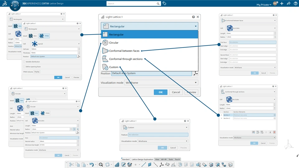

The Light Lattice panel is fully redesigned in release R2025x. The picture shows the new panel in release R2025x and the corresponding panels of each replication modes.
