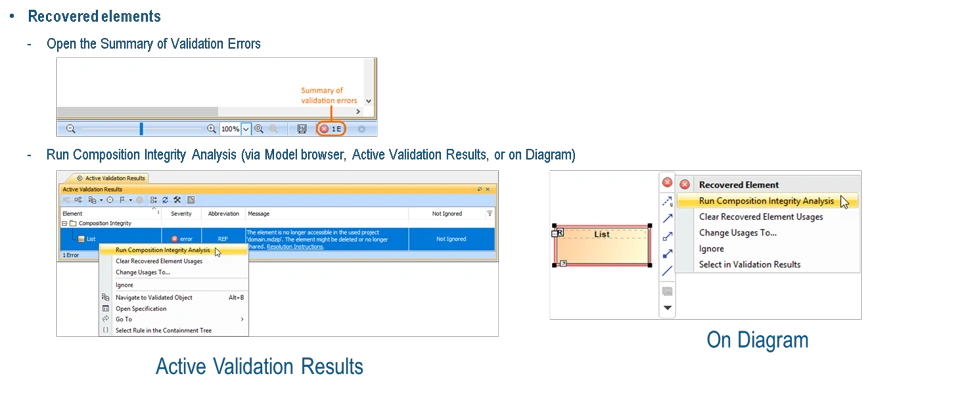

Running Composition Integrity

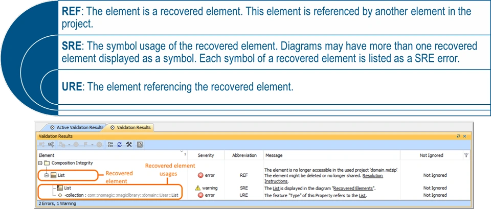

Identifying Validation Errors
Handling Recovered Elements
•It is recommended that you eliminate recovered elements from your model, using one of the following methods:
•Eliminate the causes of the element recovery. This is the case when recovered elements still exist. Identify the cause of the element recovery and eliminate it by, for example, sharing the package that contains the recovered element, moving the element back from a non-shared location to the shared one, etc.
•Restore recovered elements. This is the case when recovered elements no longer exist but can be restored from the bits of information the modeling tool still has. The restored element has only ID, name, and type.
•Manage the unresolved references that refer to the appropriate recovered elements. This is the case when recovered elements no longer exist and cannot be restored.
