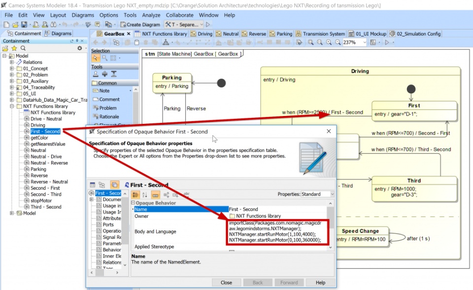

Java API of LEGO Mindstorms NXT is accessed by Cameo Systems Modeler plugin [2nd reference], which enables below functions in the model to control motors and read sensors data.
NXTManager.startRunMotor(x,y,z);
x – Motor number starting from 0
Y – Power (with “–“ in front if direction is opposite)
Z – Degrees of rotation
Sample: NXTManager.startRunMotor(1,-100,4000);
NXTManager.getColorBySensor();
Sample: color = NXTManager.getColorBySensor();
NXTManager.getDistanceFromSensor();
Sample: distance = NXTManager.getDistanceFromSensor();
NXTManager.stopRunMotor(x);
X – number of motor
Sample: NXTManager.stopRunMotor(2);
Functions are used in custom created opaque behaviors library associated with state machine states to execute when entering the states, leaving the states, and in transition. Fig. 1 demonstrate setup and use of the opaque behaviors library.
Setup and use of open behavior library with functions to control LEGO
