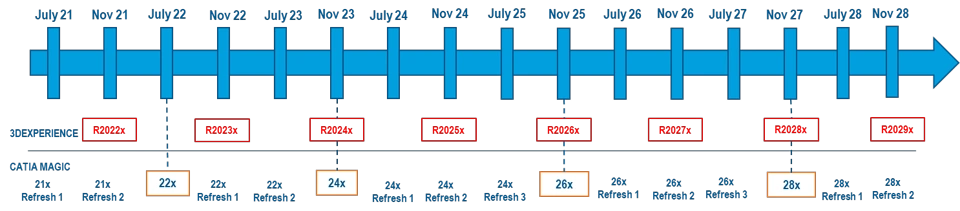

Starting 2022x, CATIA MAGIC release changes every 2 years with up to 3 refreshes for each Release.

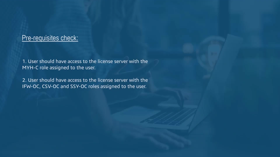

📌Minimum and Recommended Hardware and Software Prerequisites
Please refer to this page to have access to the list of On Premises & On The Cloud Certified Workstations
To enable the usage of CATIA MAGIC while connecting to the platform, you must have at least 3 platform roles: 3DSwymer, Collaborative Designer for CATIA MAGIC and Collaborative Industry Innovator.

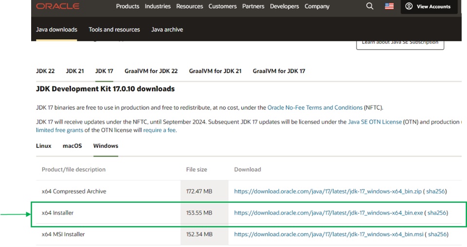

During the installation of your CATIA MAGIC connector, you might be asked to download the right Java version here.
