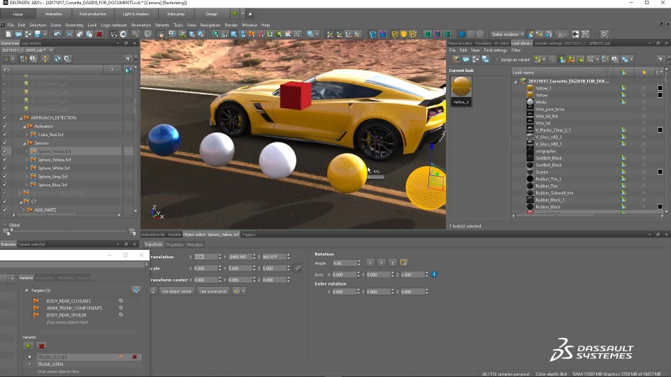

Today i would like to share with you some tips & tricks to get interactivity with your model, using some advance features of DELTAGEN.
By combining your define variant manager, the triggers, and approach detection, you will be able to use a geometry in your scene as a trigger for activating an animation, or a variants, by approaching this geometry to another one.
See in this video the step by step actions to enhance your model interactions and review.
