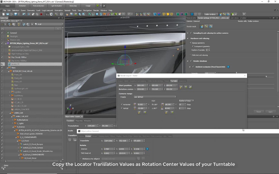

If you are looking to produce high quality content that offer Raytracing / Global Illumination quality, with semi-interactivity and easy to manipulate, we have THE solution for you.
Turntable is a convenient way to render a DELTAGEN scene using fixed-steps animated camera. Its use optimizes the visual analysis and comparison of models in the design and review processes for none CGI skilled peoples.
The video below show the process to set the Turntable parameters and produce it as an output content as *.mov file that you can share afterwards with your team and project manager. This sequence of images package as a movie file can be viewed with Quicktime.
