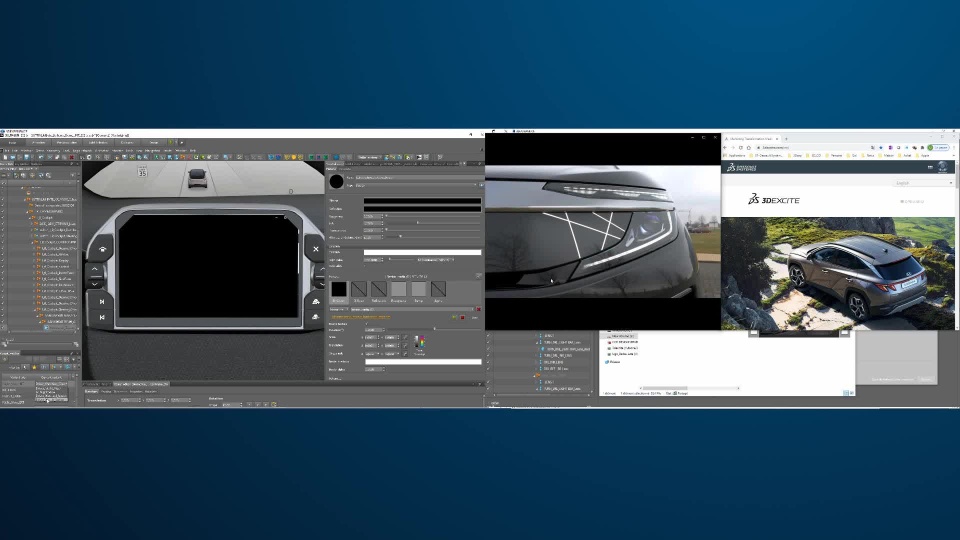

Today what we can achieve is to stream what is displayed in a machine into a specific area of a DELTAGEN model.
For this we use the Interactive Texture agent module, setting up the computer to stream into a material interactive texture or an overlay, and set choosing the windows or area to stream.
Interactive Texture Setup

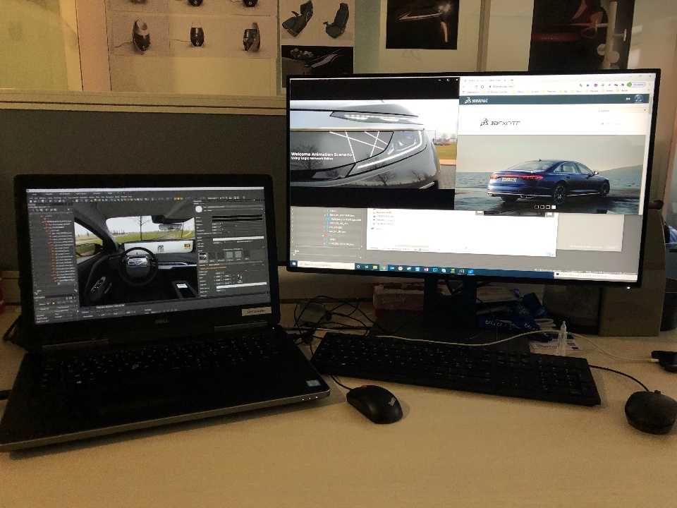

  1. Install only the interactive texture agent on the computer to display, then launch it. But you could install that also on the same machine if you want to stream another windows hidden
  2. In DG, load the Interactive Texture module in Tools.
  3.  the user preferences and set up an agent in interactive texture submenu. Use the name of the computer to reach and use VPN in case you're out of the office network.
  4. Created a new configuration in the interactive texture agent window by selecting the computer to reach, and its specific windows or area to stream.
  5. Then you are able to select the configuration in the Diffuse texture bank, and press play to activate it. Anti-Aliasing needs to be activated.
