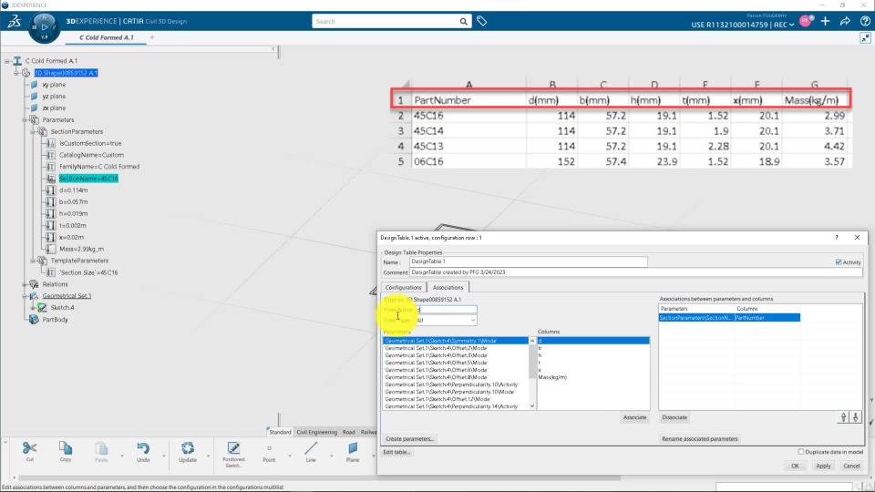

Steel Structure Custom Sections
Tutorial showing how to create a steel structure custom section, that you will be able to use as an object type in both Civil Structure Design and Civil Structure Engineering applications.
Mandatory parameters (same name) :
Under SectionParameters set:
IsCustomSection(Boolean)
CatalogName(String)
FamilyName (String) (value of this parameter should be the name of the shape and the same name as the title of the product)
SectionName (String)
Under TemplateParameters set:
Section Size (String)

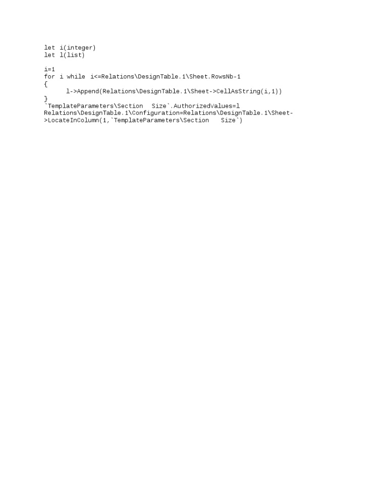

The configuration rule used in the video to drive a design table configuration through a parameter:
