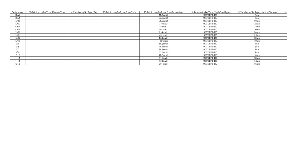

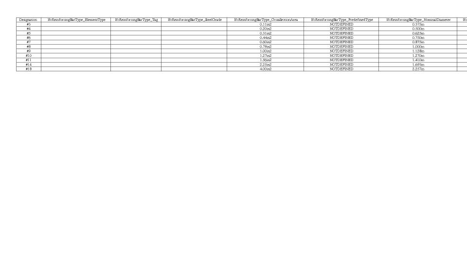

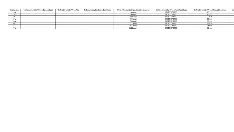

Configuration Tables
You can also customize Configuration Tables (by default it is the french one in RebarTemplates.3dxml) as described in the main Rebar page of this wiki.
Here are some samples for different countries :
FRANCE :
USA:
CANADA :
