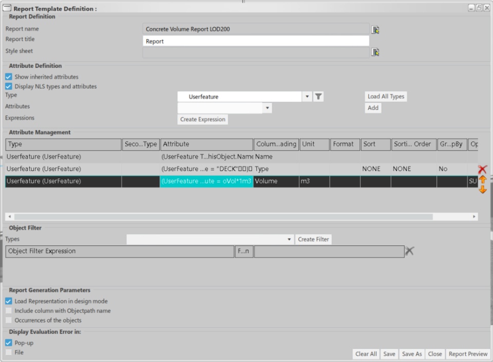

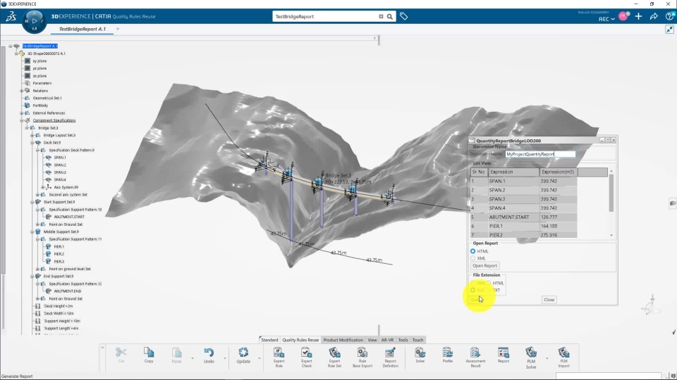

Short example showing how to create a Knowledge Report to extract QTOs for LOD 200 (features) from the Bridge Design Assistant. Process is similar if you want to extract output parameters from a UDF to generate your report.
When saving the report, it is stored by default in C:\\Users\\*YOUR-USER-NAME*\\AppData\\Local\\Temp

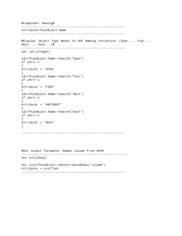

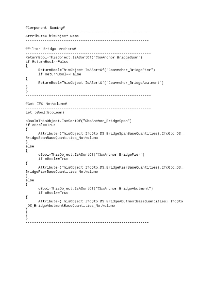

EKL from the video is available in this text file:
if you defined UDFs (User Defined Features that are named Span..., Pier..., Abut..., Deck...) for your templates and have output parameters such as Volume below.
