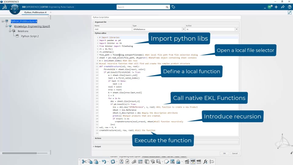

A simple demonstration illustrating some unique capabilities offered by the python language for design automation scenarios.

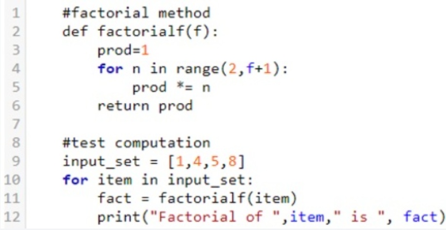

The Python script below is computing the factorial:
