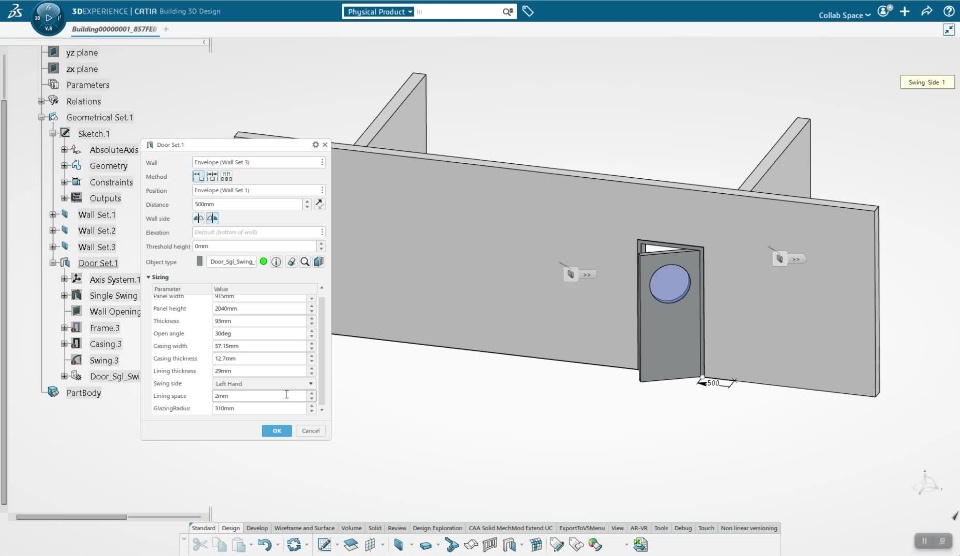

Like for walls and slab, it is possible to assign an Object Type with a UDF to a Door (and Window) feature.
The list of input parameters that the UDF can obtain for the features is in the table below. The only mandatory input is the Position axis system, Usually the outputs will contain a surface, or a volume named Opening, used to cut the opening in the wall.
The attached movie shows how the controls to position the door feature work seamlessly for the UDF outputs too.

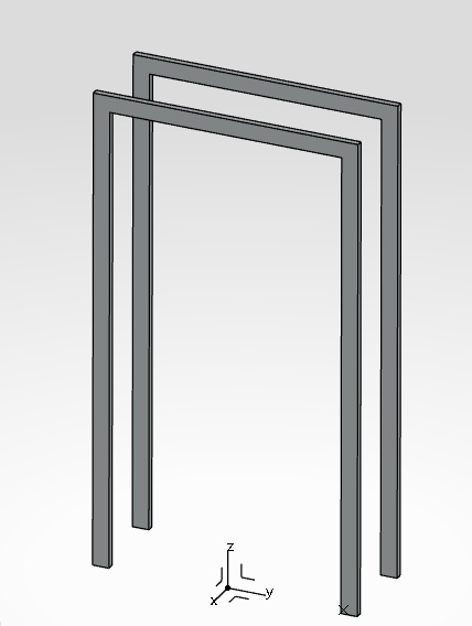

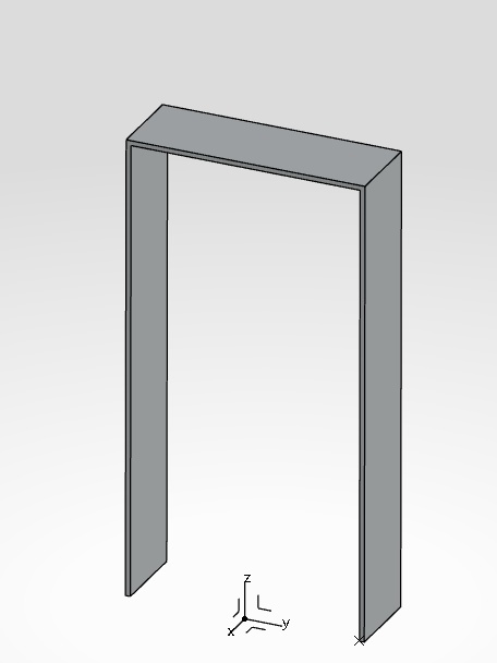

CasingWidthThe width of the door’s casing
CasingThicknessThe thickness of the door’s casing
LiningThicknessThe thickness of the door’s lining
LiningSpaceThe gap between panel and lining

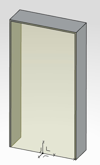

OpeningAn UDF output surface or volume used to cut the opening in the wall
TEMINOLOGY

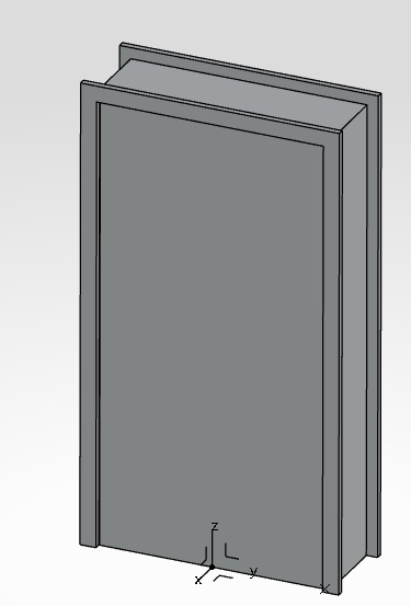

Complete DoorCasingLiningOpening (in yellow)
A Door feature with a Door Object Type

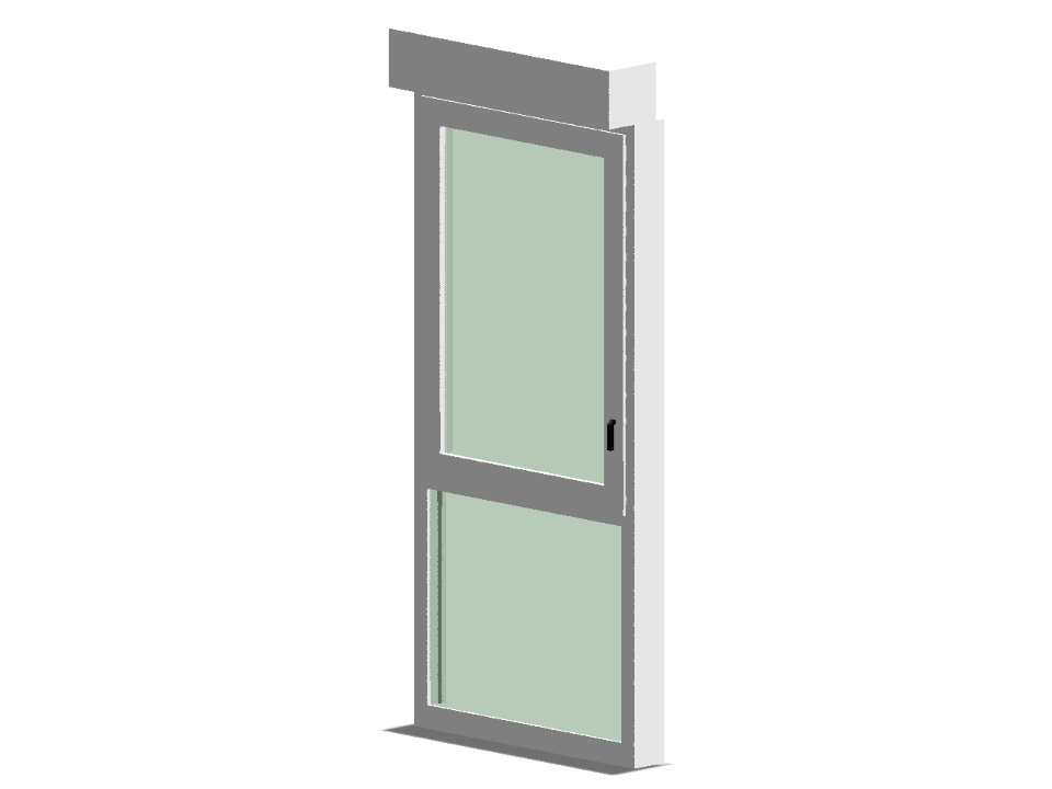

Similar considerations apply to a Window feature
WINDOW
PositionAxis System used to position the window, typically at the bottom mid-point of the window’s panel. Z up, X normal away from the wall
WallThickness  The thickness of the wall hosting the window
WidthWidth of the window
Height Height of the window
CasingWidthThe width of the window’s casing
CasingThickness The thickness of the window’s casing
LiningThicknessThe thickness of the window’s frame (lining)
LiningSpace The gap between window and frame (lining)
GlassThicknessThe thickness of the window's glass
OpeningAngleThe open angle of a casement window
SashWidthThe width of the window's sash
SashThickness The thickness of the window's sash
