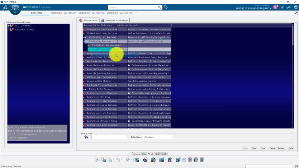

See how to setup your environment to leverage ASD (AITAC SMART DRAWINGS) and the Multi-Discipline Drafting app.
Default ASD Resource Set can be found under : C:\\Program Files\\Dassault Systemes\\B424_Cloud\\win_b64\\startup\\AITAC\\DefaultResourceSet

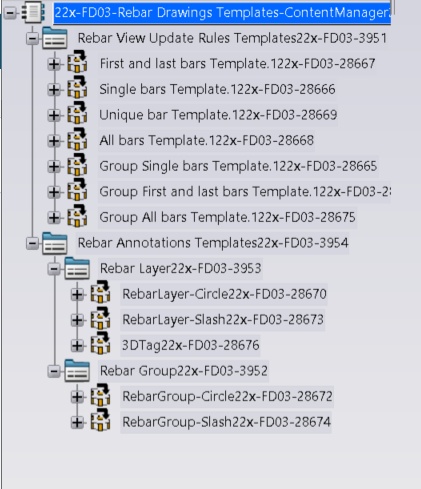

Path for the rebar drawing templates : C:\\Program Files\\Dassault Systemes\\B424_Cloud_Content\\win_b64\\startup\\Civil\\Rebars\\DrawingTemplate
UPDATE 2022x FD03 : the DrawingTemplate file has been enriched. In addition to View Update Rules, you need also to copy the Rebar Annotations Templates in the picture below inside the Annotation Templates Chapter (not shown in the video, but similar step by step as for View Update Rules).

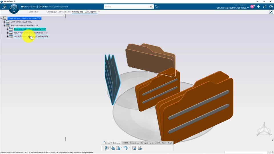

Additional data setup for alignment drawings
Path for the alignment drawing templates : C:\\Program Files\\Dassault Systemes\\B424_Cloud_Content\\win_b64\\startup\\Civil\\Alignment\\DrawingTemplate
