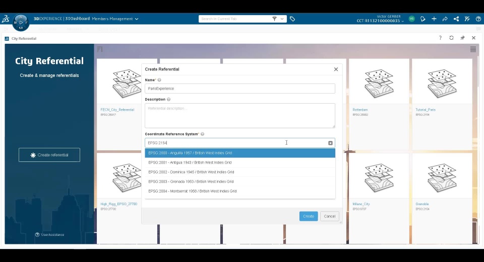

Choose your area for PCS
There are several standards to define area, one of the best known and used is the EPSG (European Petroleum Survey Group). Go to the web site epsg.io to determine area that is fitting the best to the need. You can check open data next to the project’s location and choose the area that includes it.

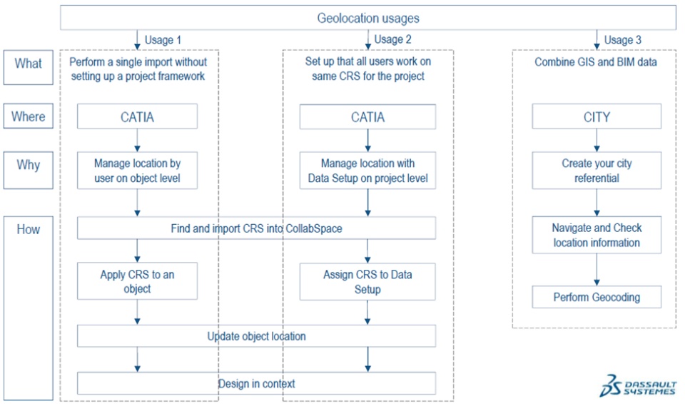

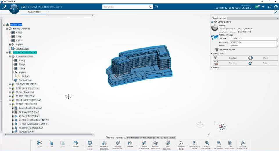

There are three Geolocation usages in CATIA and CITY :
- You want to perform a single import without setting up a project framework
- You want to set up that all users work on same CRS for the project
- You want to combine GIS and BIM data

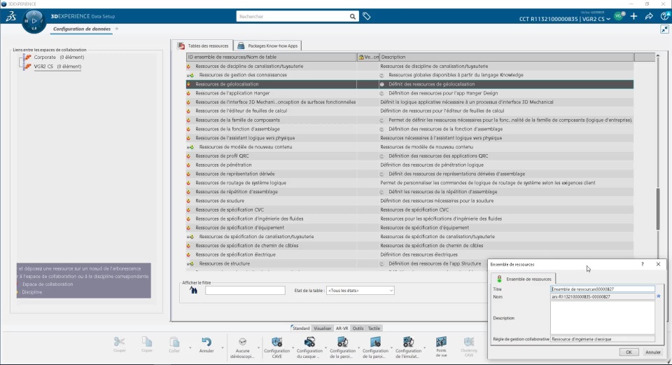

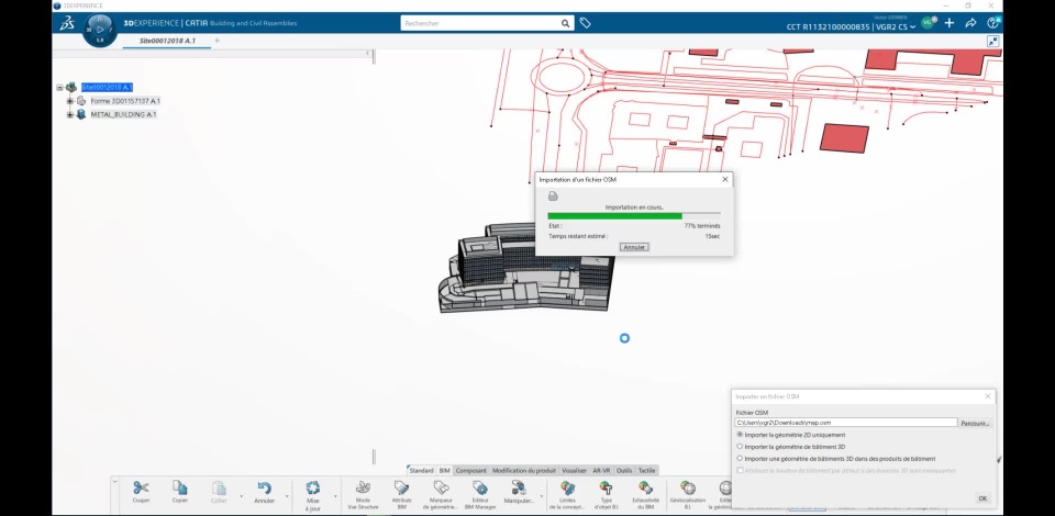

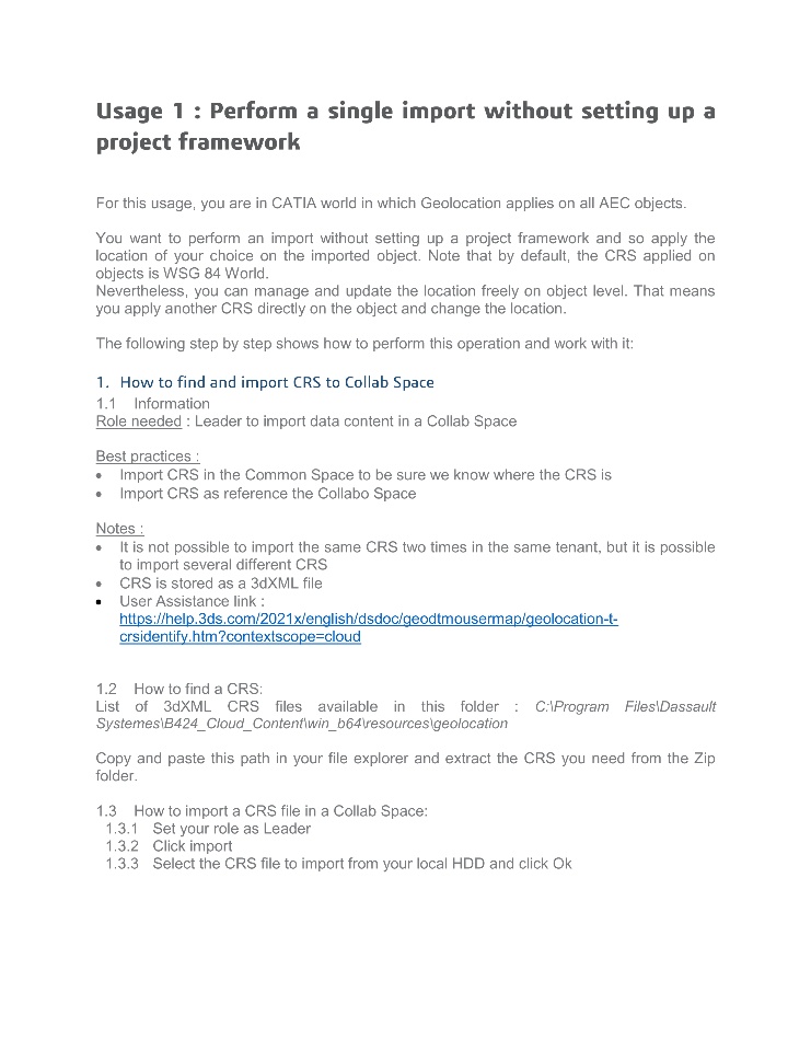

Usage 1 : Perform a single import without setting up a project framework
Videos :

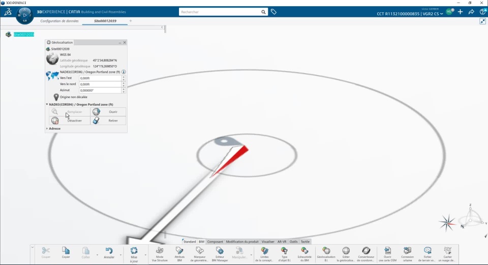

Apply CRS and update location

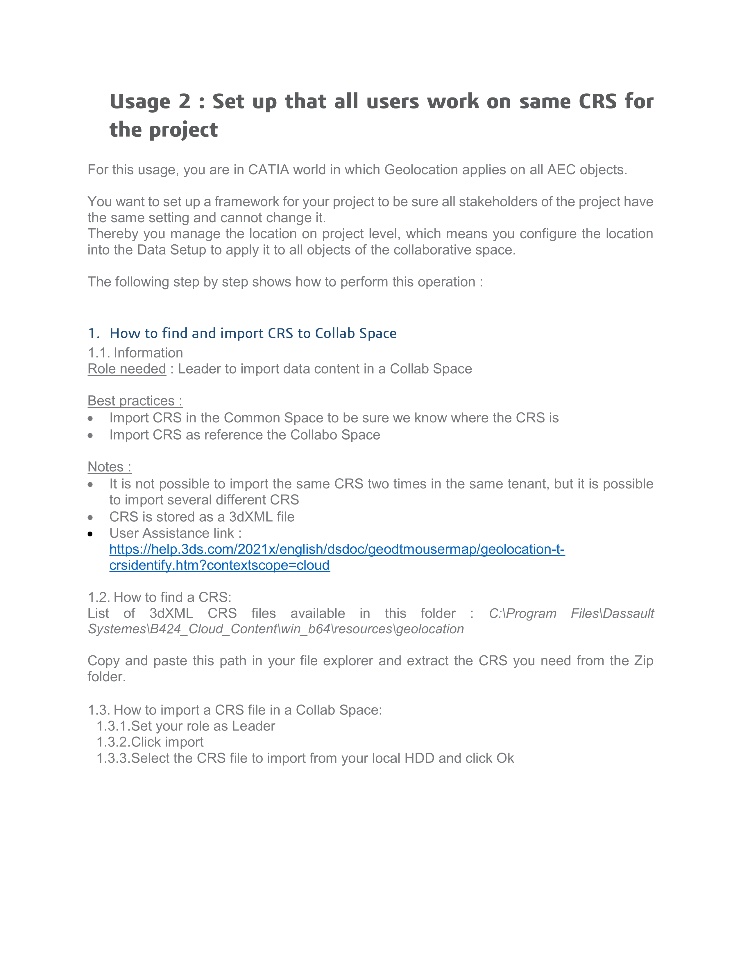

Check origin and align Design in context Usage 2 : Set up that all users work on same CRS for the project
Videos :
Assign CRS to Data Setup

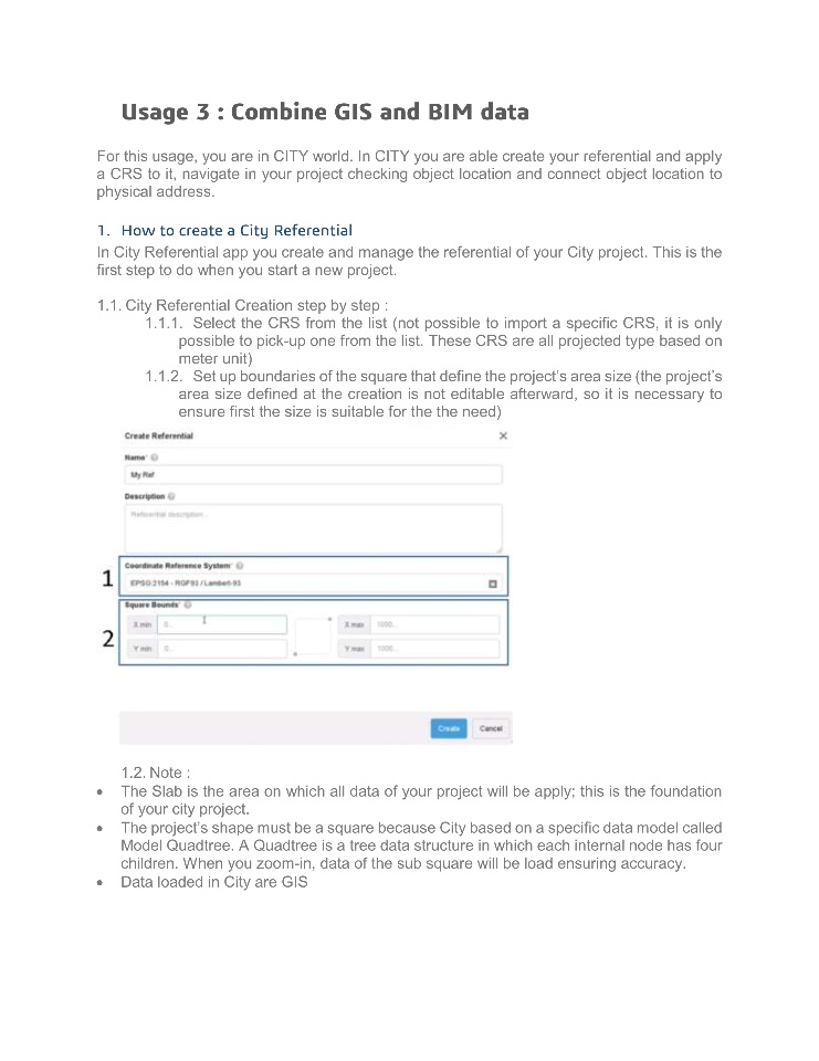

Apply CRS and update location Design in contextUsage 3 : Combine GIS and BIM data

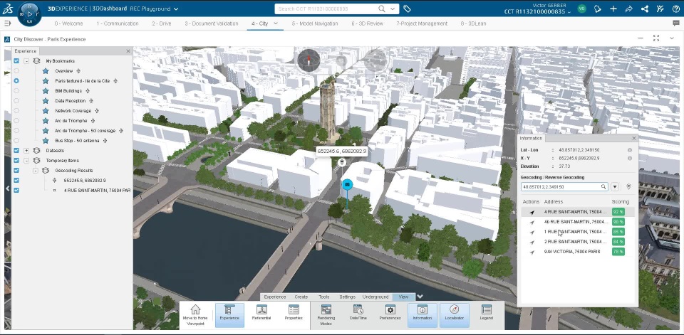

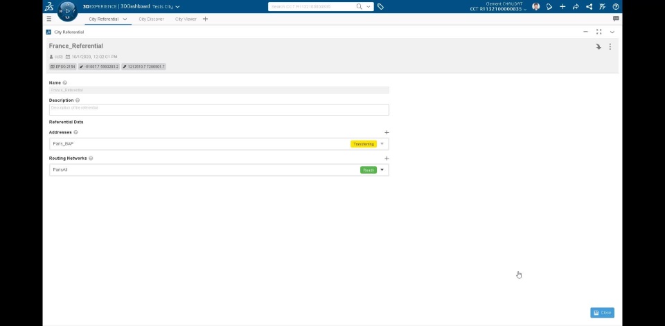

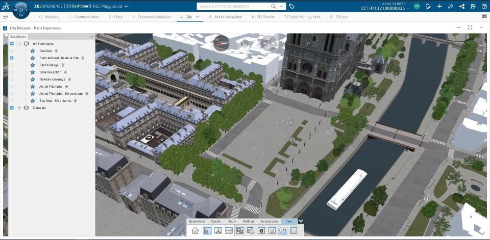

Videos :
Create referential
City navigation and location Geocoding source file import and setup Geocoding usageWhere can I find more information
