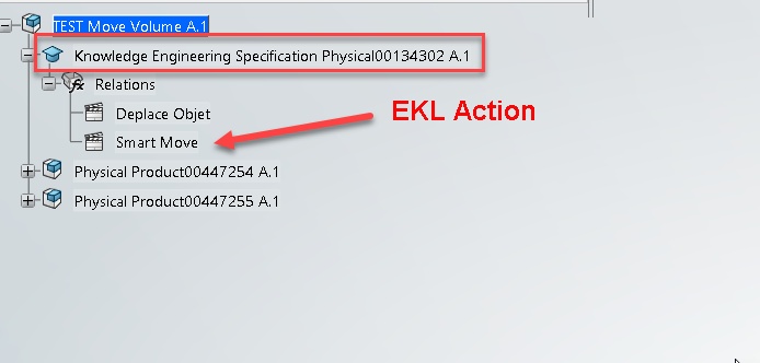

Create in a Product a Knowledge Engineering Specification and Create inside your EKL Actions

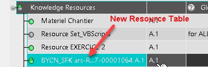

In the Data Setup, under  "Knowledge Resources"  create a new Knowledge Resource Table if you don't have any
Open it and add inside it Add a new Resource

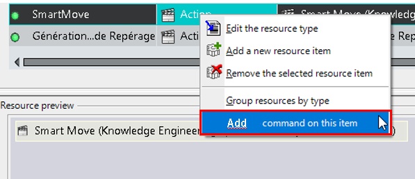

Give it a Logical Name, a Type and select the Knowledge Engineering Specification in which it is stored
Do a right Click to Add a Create a new command on this Action
Deploy your Resource Set to the desired Collab  Space and Save

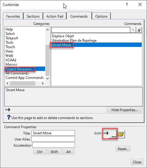

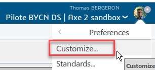

Than switch to the App in which you want to have access to this Command and go to the "Customize" menu
Under the "Commands" Tab and in Project Resource you should see your command:.
you can assign it an icon

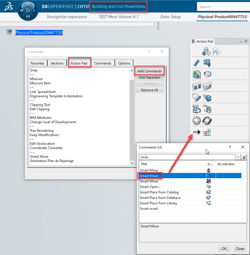

At this point you probably need to restart your CATIA session and go back to the Customize Panel

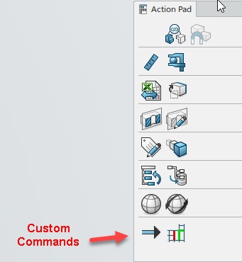

This time switch to the "Action Pad" Tab and Add you command. you will find it in the Commands List
This is it!
