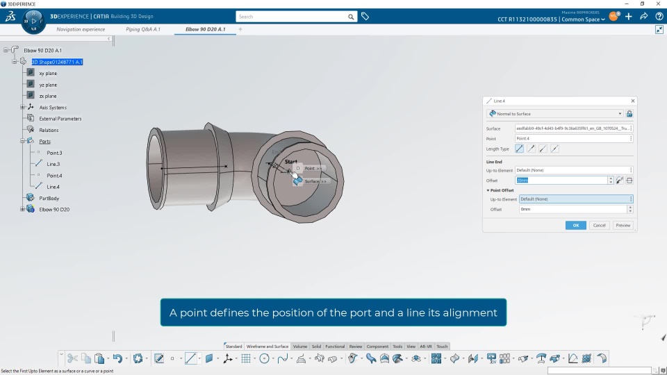

- Port creation
- At 3D shape level, switch to the Building 3D Design App
- Create two points at the center of each interface and a line representing the alignment
- At 3D shape level, switch to the Piping & Tubing 3D Part Design App
- Select Manage Ports and creates two ports using points and lines previously created for “Extremity Point” and “Alignment”
- Select Port Attributes where you can define attributes (e.g. outside diameter). Each attribute must be filled
