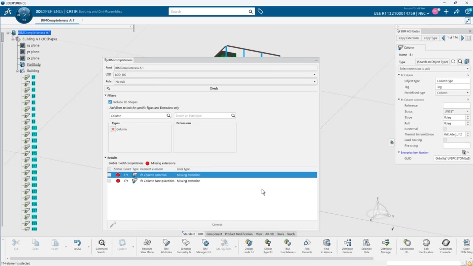

BIM Completeness and Converters
Tutorial showing the different ways to import IFC files (same process applies to Revit converter) and how to check if BIM attributes have been properly filled in, using the BIM Completeness tool.
At then end of the video, a batch (new in 2024x FD01) provides the capability to massively checks the BIM Attributes in 3DX data whether it has been created natively in 3DX or imported using IFC or Revit converters.
