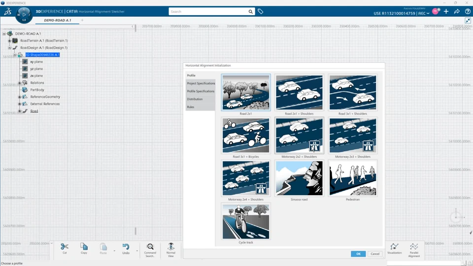

2 - Set Up Your Alignment Project
Tutorial showing how to set up your alignment project.
By default the following files are used for your project :
Alignment Design Rules (curve radiuses by speed,...) : C:\\Program Files\\Dassault Systemes\\B426_Cloud\\win_b64\\startup\\Civil\\AlignmentDesignRules
Alignment Design (type of road, such as 2 lanes, 4 lanes, and default road values...) : C:\\Program Files\\Dassault Systemes\\B426_Cloud\\win_b64\\startup\\Civil\\AlignmentDesign

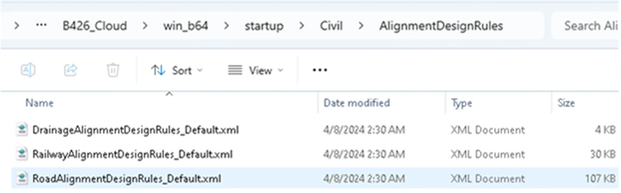

If you want to create your own predefined set up or rules, you can use the start up files from the following folders:
Xml for profile setup : C:\\Program Files\\Dassault Systemes\\B426_Cloud_Content\\win_b64\\startup\\Civil\\AlignmentDesign
xml for design rules : C:\\Program Files\\Dassault Systemes\\B426_Cloud_Content\\win_b64\\startup\\Civil\\AlignmentDesignRules

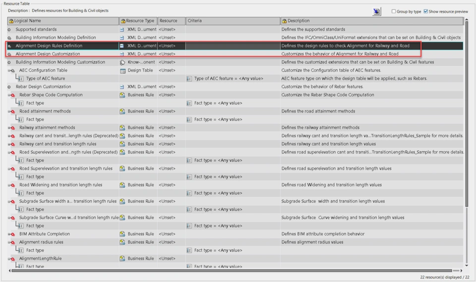

And add those in your datasetup under Building & Civil Resources :
Add the modified xml files as Resource

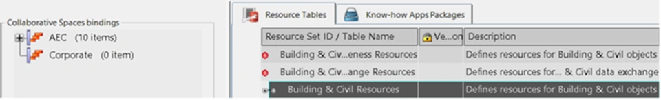

And bind the resource set to your collab space
