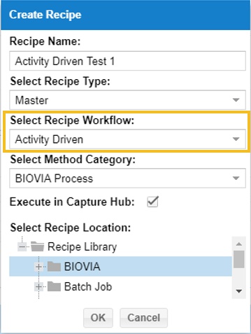

Start by going to Compose and create a new recipe. It can be a General, Site or Master.
Select the Activity Driven Workflow and fill the rest of needed information.
Remember to check the "Execute in Capture Hub" to use New Capture.

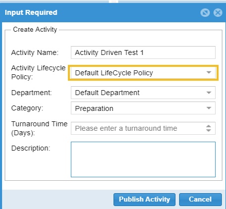

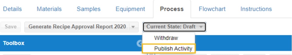

Configure your recipe as usual. When the recipe is in at a state where you would like to test it, click Current State and Publish as Activity.
Select the Default LifeCycle Policy in the following screen:
Your activity is now available and can be tested in a Task Plan.
