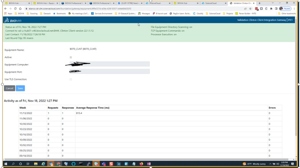

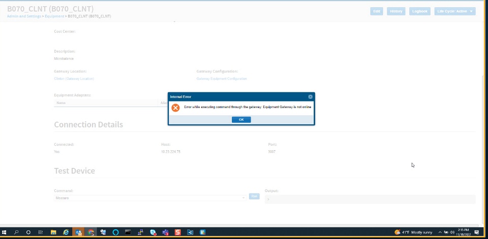

We recently had an issue at customer environment where the equipments were not connectible. This is one example of variety of issues you can find . Please see SR00957674-01 for more details.
The issue here was, the Integration Client was configured first and the equipment's were migrated later . Even though the equipment status says connected its actually not known to the Integration Gateway Client.
Customer had to the below steps to resolve the issue.
For example just pick one of the balance "B070_CLNT (B070_CLNT)"
1. Change the Lifecycle event  from Active to Upgrading.
2. Edit the balance and disconnect from the Integration Gateway Client by changing the Gateway Location from Clinton to Empty and save.
3. Then reconnect the balance to Clinton Gateway.
4. Change the Lifecycle event  from Upgrading to Active.
5. Connect it back to the Integration Gateway Client and confirm its working.
After following this , the balance was again connected so customer had to follow this for all other equipment and they were reconnected to the Integration Gateway Client.
Error message before reconnecting the Balance:-
