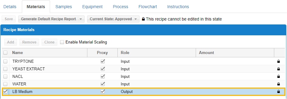

You will need to start as usual by adding the material as an Output in the recipe's Material tab.

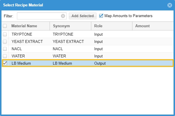

 Then, in the Process tab, at the step where the product should be registered, add this material in the step's Material tab and check the Map Amounts to Parameters.

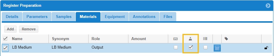

Then, check the Register Material box:

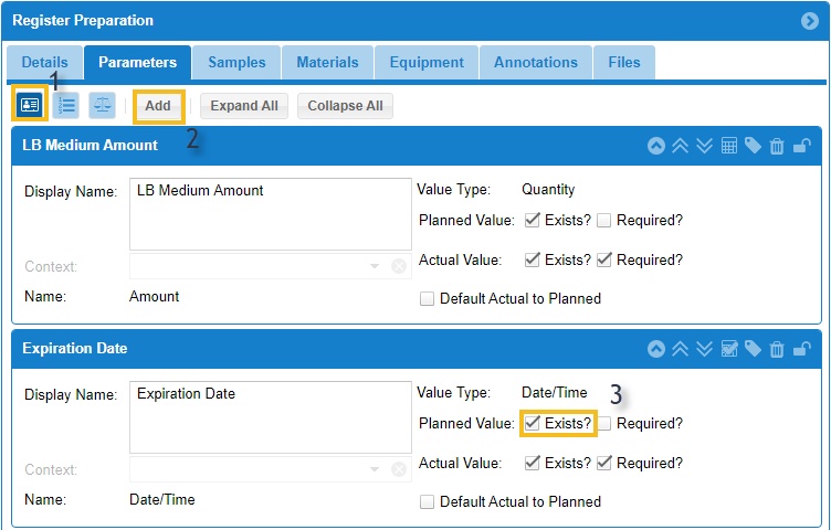

 Now, in the Parameters tab, you'll see a Material Amount parameter created. Add an Expiration Date parameter. Make sure a Planned value exists for this parameter.

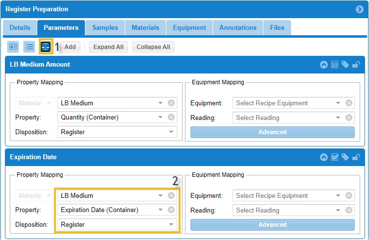

Go to the parameter mapping view and define the Property mapping for the Expiration Date as shown below (note that the Amount parameter should already have one).

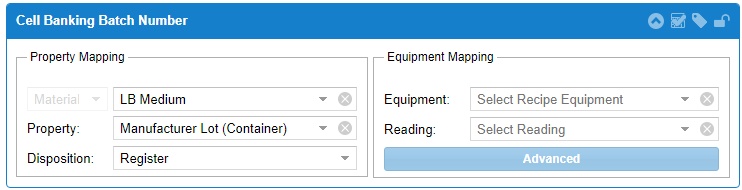

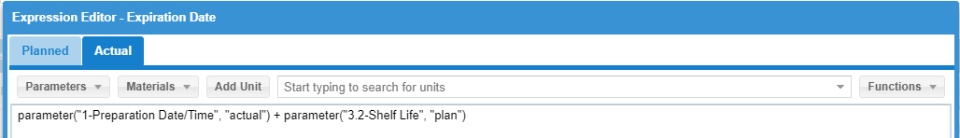

You can add additional parameters (such as Lot Number, Manufacturer, etc.) to associate with the batch that you register.
You can also setup calculation to the Expiration Date as it is now a classic parameter.
