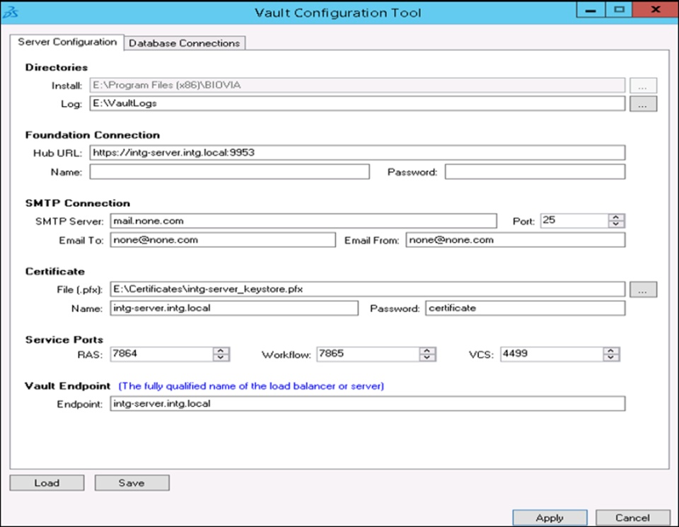

·         Run the Vault Configuration Tool (via Apps > BIOVIA on a Server), and update the certificate information in the appropriate fields. This step will update all the relevant Vault configuration files where the certificate is used, such as, the Vault Client Service. Ensure that the information is populated and correct in all the other fields in this dialog box( for ex User name and password for Foundation Connection etc).
Click “Save” to validate and then, click “Apply”. The above dialog box will become grey, and then, it will re-appear.
·         The Vault services will start running automatically. IIS (WWW Publishing Service and IIS Admin Service) will start running automatically.
·         Click “Cancel” in the Vault Configuration Tool to close the dialog box.
