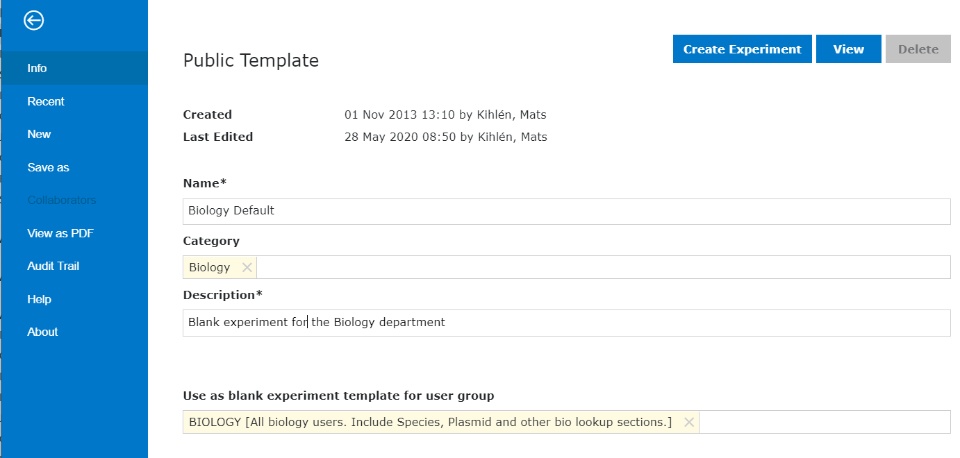

  • Create a public template and add the appropriate sections
  • Select the group for which the template should be the master on the template Info tab:
