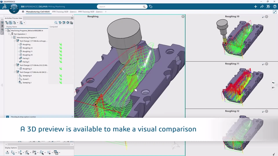

- Powered by AI - automatic generation of alternate toolpath strategies and parameters enables NC programmers to minimize the machining time in roughing operations

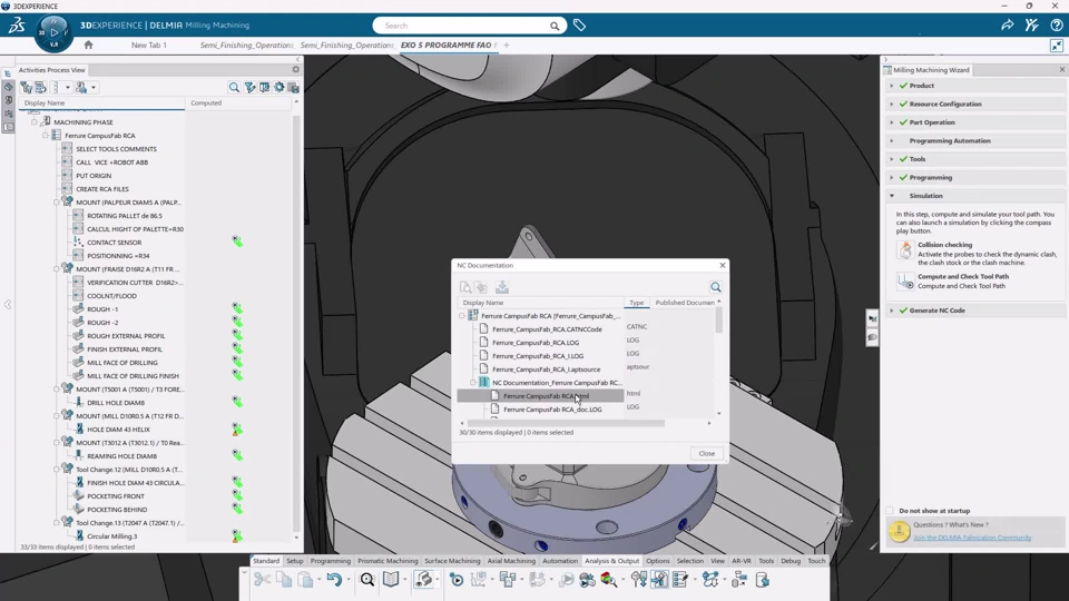

- Support shop floor operator by delivering a NC Documentation that is flexible and easy to customize.

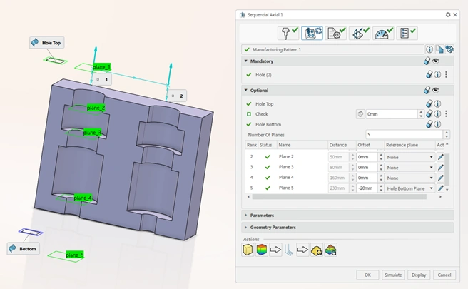

- Increase flexibility and efficiency of sequential axial operation simplifying selection of bottom and top and adding circular motion.

Support the shop floor operator by delivering an NC Documentation that is flexible and easy to customize. Generate NC documentation, define pictures, and customize the output using XML and/or HTML format.

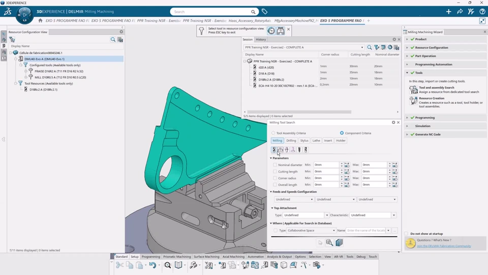

Simplify the selection of cutting tools using a search with history or by filling measured geometries. Fill the parameter value using measure. Select the search location from all available locations using the Where filter for libraries or collaborative spaces. View the relevant resources from all opened tabs using the “All tabs” option available in the Session Panel.
Increase the flexibility and efficiency of sequential axial operations by simplifying the selection of bottom and top, and adding circular motion. The axial plane of a sequential axial activity references the stock top plane, stock bottom plane, hole top plane, hole bottom plane, and other axial planes. Define a sequential axial activity in a more generic way.  Define a chain of planes with the ability to use another axial plane as a reference.
Minimize the machining time in roughing operations leveraging AI to automatically generate alternate toolpath strategies and parameters. AI suggests a preferred tool path strategy and parameters for the selected geometries in Roughing and Prismatic Roughing Operations.
