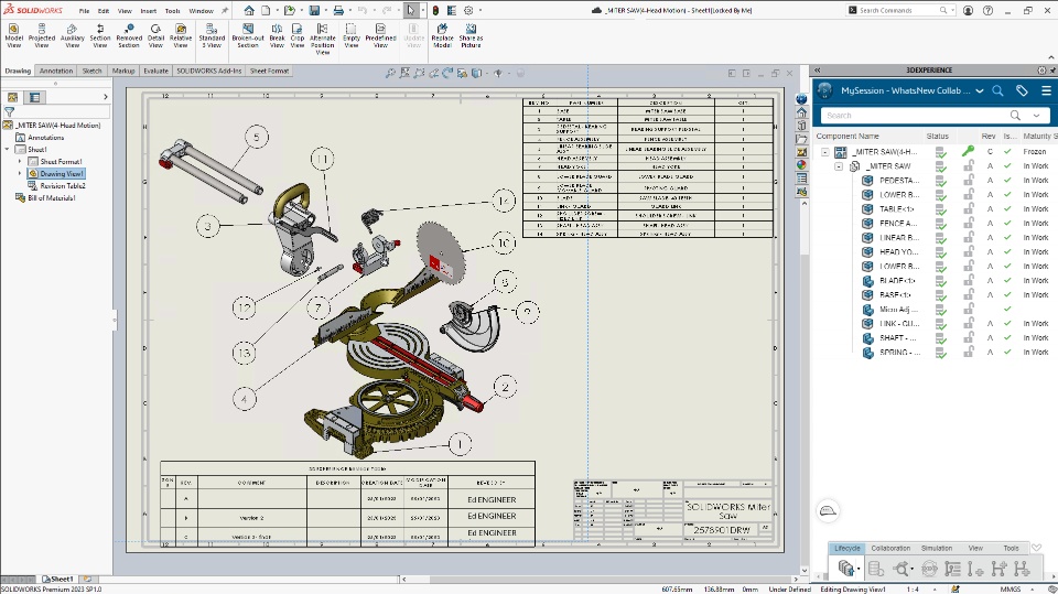

SOLIDWORKS users will now have the ability to map drawing balloon numbers to the 3DEXPERIENCE Platform improving cross collaboration and efficiency.
Map revision comments history to SOLIDWORKS drawings for better visibility & traceability of the data.
With bi-directional syncing of drawing revisions, revision history table automatically updates

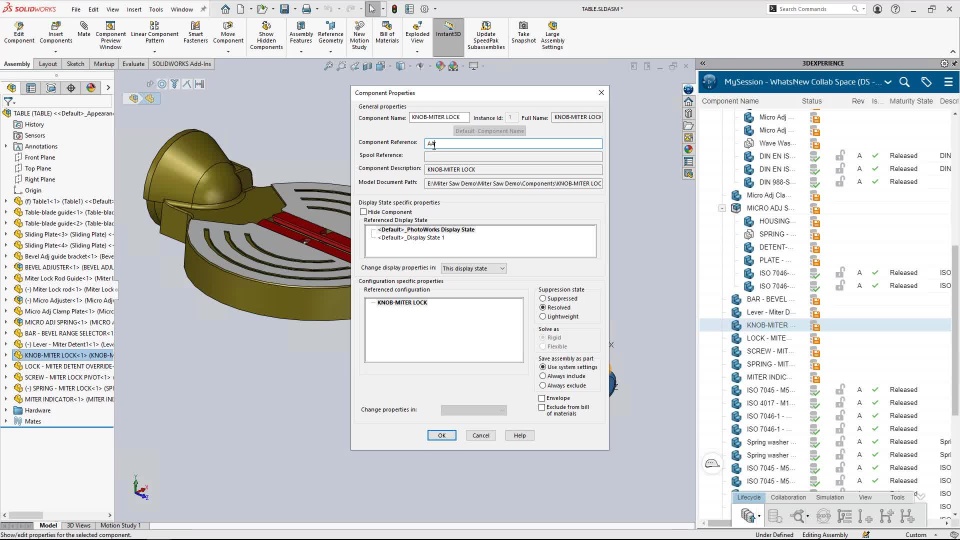

When you say "drawing balloon numbers", I see "Component Reference" in the 3D. I understand that Component Reference could be used as BOM Number in the drawing and be shown in the balloons instead of the automatic item number, but can you elaborate on that ?

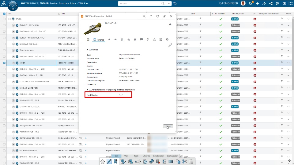

Adil, we really need this functionality and were pleased to find this post.  The miter saw example looks perfect on the surface.  The flaw in the example is that an assembly like this would by multi-level assembly. Many parts & sub-assemblies within many parts &sub-assemblies.  This functionality only works for the top-level assembly.
We (and many of our vendors - industrial rotating equipment providers) use (Find Number) in product line assemblies to reference ​Ballon items found in Part List Drawings attached to Maintenance Manuals that correspond to the customers Serial Numbered Bill of material.  For Example, BOM from Product Release Engineer - Printed in Excel, Serialized and provided to customer as an addendum to their Maintenance Manual.  In this use case we require the Find Number (Component Reference) to be unique forever instance that a Bolt appears in an assembly regardless to how many levels of the BOM.  See Attached Image.  Note:  For use to get the functionality you are presenting our entire pump assembly and its variants, all parts would need to be in the top-level assembly.  This is impractical.  The functionality we are looking for is common for all pump, valve, motor, mechanical seal mfg.'s and more.
