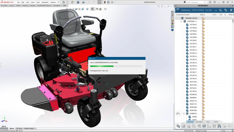

It is now possible with Collaborative Designer for SOLIDWORKS to select Windows folders with SOLIDWORKS models to upload those to the 3DEXPERIENCE platform.
User Experience Value

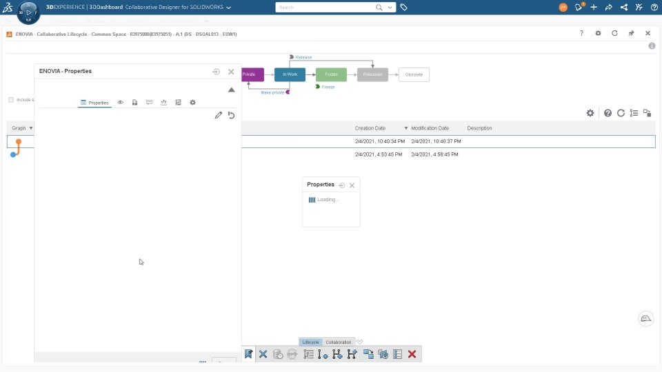

Feedback to the user while saving data to the 3DEXPERIENCE platform has received significant improvement and now reports the time to completion. New lifecycle commands are now available directly from within SOLIDWORKS. CAD Models uniqueness is now also enforced while creating items from the 3DEXPERIENCE platform. Auto-Naming becomes an administrator setting and can therefore be controlled for all users.

Improved Save Experience, Duplicates detection, Server side settings management.
The Save dialog has significanly improved and now provide details on the actions required before the Save operation is complete.

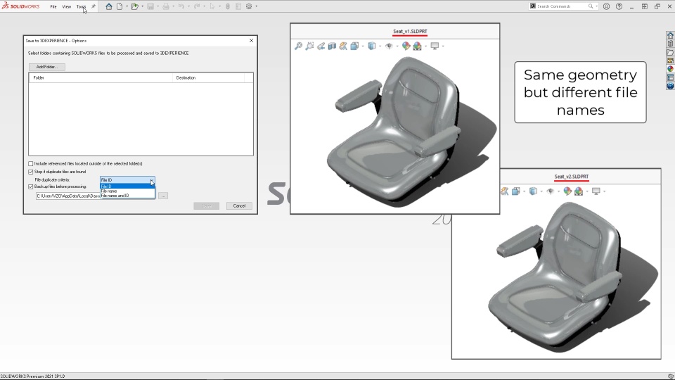

The Save to 3DEXPERIENCE command now allows better management for duplicates. The process could stop in case two files with the same name are found or even if file names are different but the geometry is the same.

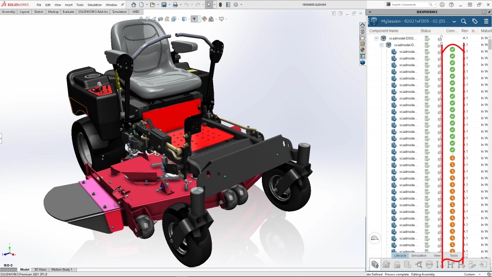

Conversion to Exact Geometry for SOLIDWORKS files can now be performed in the cloud directly reducing the load on the user machines.
