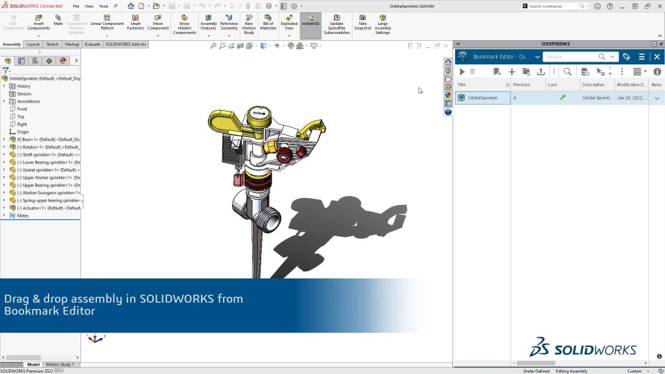

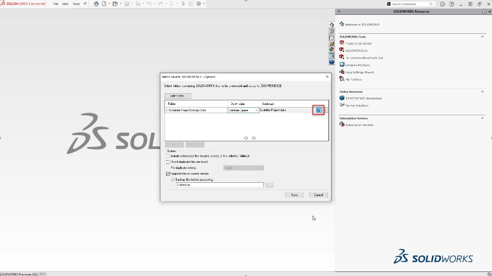

Batch upload tool continues to be improved and now has additional uniqueness checks to prevent duplicates from being created. This reduces the use of storage and enforce a single source of truth for SOLIDWORKS objects. While moving data to the 3DEXPERIENCE platform it is now also possible to automate bookmark assignment to seamlessly organize 3D data and more tasks are done on the cloud to drastically improve performances.
Users will now have the ability to quickly access related objects from their design tree giving them a better contextual understanding of their designs.
New command introduced to launch Bookmark Editor from Save dialog

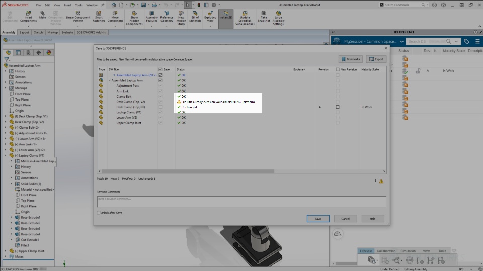

Warning provided to the user at Save if File Title is already used in the 3DEXPERIENCE Platform
