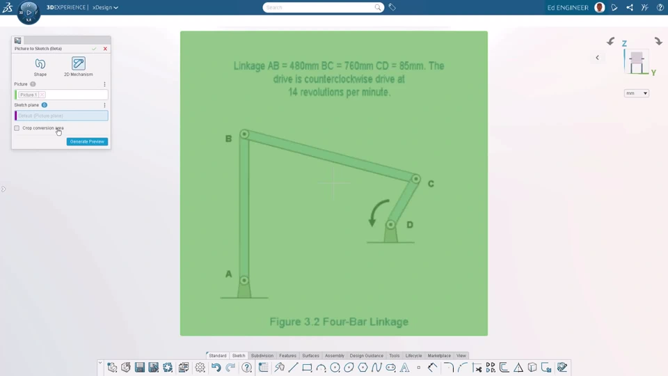

Convert a picture to a 2D Mechanism. Create custom environments for designing in context of an experience.

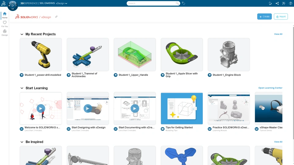

Resume your design work seamlessly by restoring unsaved data or opening recent content from any xDesign session, regardless of whether it’s opened in the same widget or not (Only available in SOLIDWORKS xDesign for Students & 3D Designer for Education)
Convert an image of a mechanism into a sketch with the new 2D Mechanism option in the Picture to Sketch tool

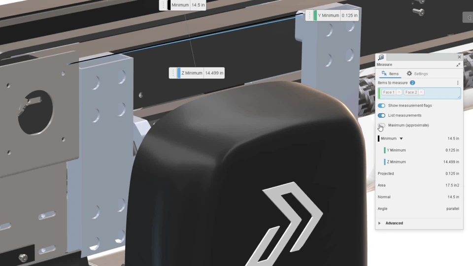

Quickly inspect and verify geometry to ensure design accuracy and intent with improvements to the measure tool

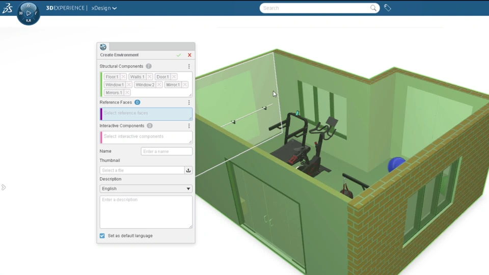

Use the Create Environment tool to create custom user defined design environments to contextualize your models
