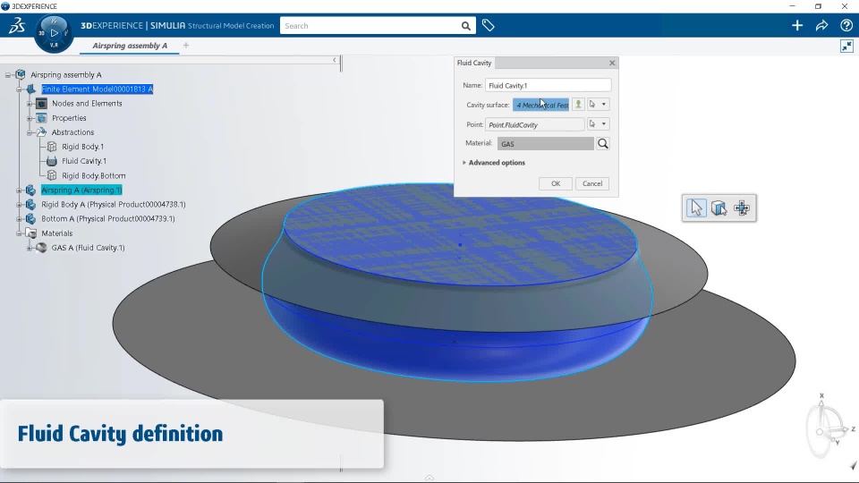

New option for selective flipping of face normals when defining a cyclic symmetry, an acoustics absorber or a fluid cavity on a shell-like model, avoiding any specific geometry modification requirement

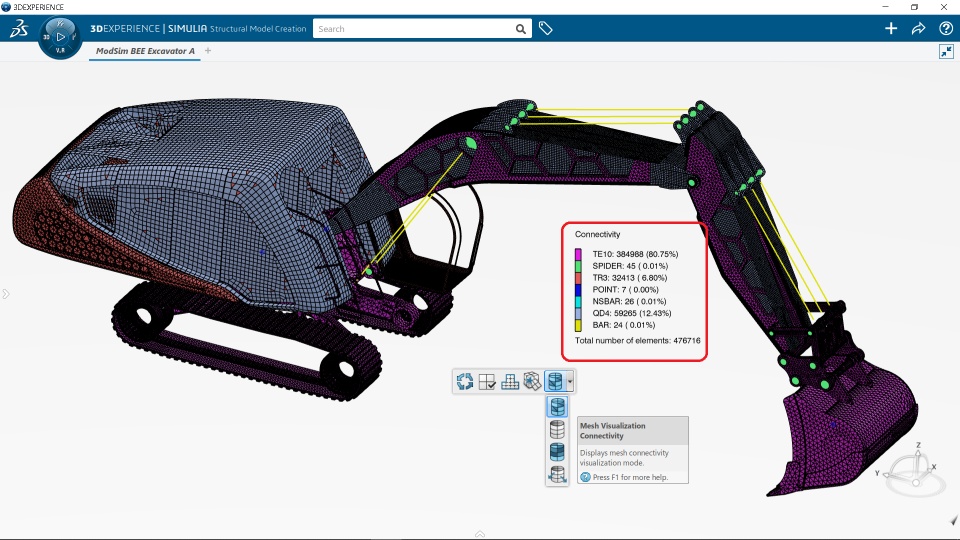

Visibility improvement by adding legends to colored mesh visualization (mesh quality, mesh orientation, interference, etc.)

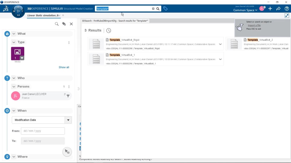

Various user experience improvements in dedicated dialog boxes for the templates (creation, management) making them more easy to use
