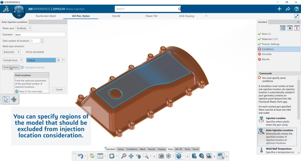

The ‘Auto-Injection Locations’ feature assesses the part geometry to identify up to 4 suitable injection locations. Obtain injection location suggestions in a few seconds thus saving time that you would normally spend in running several analyses to determine these locations.

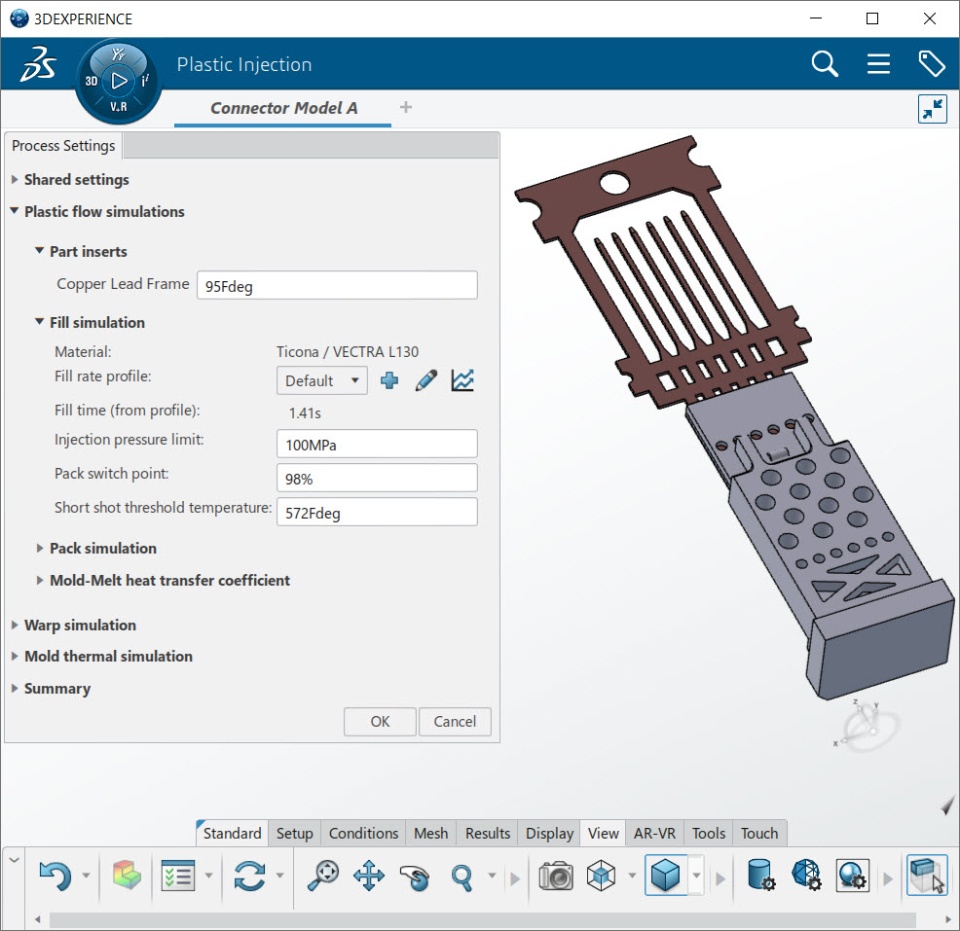

This release also features the following enhancements aimed at improving the overall accuracy of the plastics injection molding simulations:
* For part inserts, you can now specify their initial temperatures.
* Enable Mold-Melt Heat Transfer Coefficient for the Fill and Pack analyses to account for heat flux between the polymer melt and the mold wall.

The enhanced ‘Auto-Injection Locations’ feature assesses the part geometry to identify up to 4 suitable injection locations.
For Part inserts, you can now set its initial temperature.
