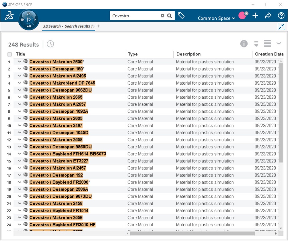

Massive database update of plastics materials in 3DEXPERIENCE. The R2021xFD03 Plastics Materials Database will have 4051 grades in total with 512 new grades added, 105 obsolete grades removed and 506 grades renamed / reclassified.
This comprehensive material data base allows users to use correct material information directly from within 3DEXPERIENCE, with an increase of 10% of plastic materials database size
From R2021x FD03, the Plastics Materials Database will have 4051 grades in total with 512 new polymer grades added, 105 obsolete grades removed and 506 grades renamed / reclassified. The plastics materials database size grew by 10% in this release. This comprehensive material database allows users to use correct material information directly from within 3DEXPERIENCE.

After installing new FD, we should import local 3dxml (ds-injectionmolding.3dxml) to use new material you mentioned. but what if they already imported material file from previous version? it appears that importing again produces duplicated materials including new material. In this case how we can import new material only ? and how we can delete duplicated materials ?
