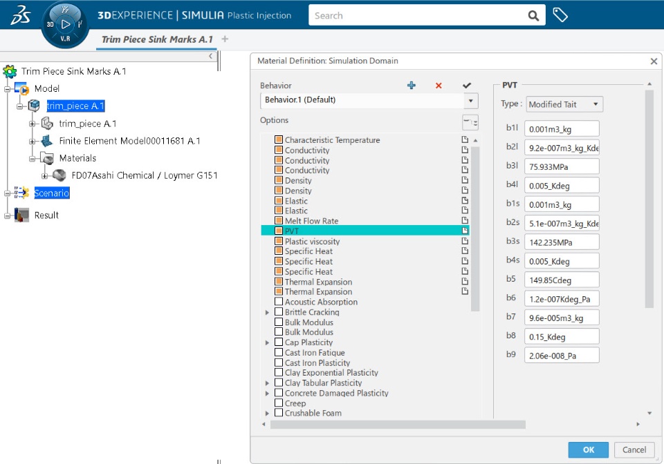

In R2021x FD07, the same Asahi Chemical Polypropylene Loymer G1512 grade has been updated from constant Density to generic PVT data, which should improve the accuracy of Fill, Pack, and Warp simulations.
