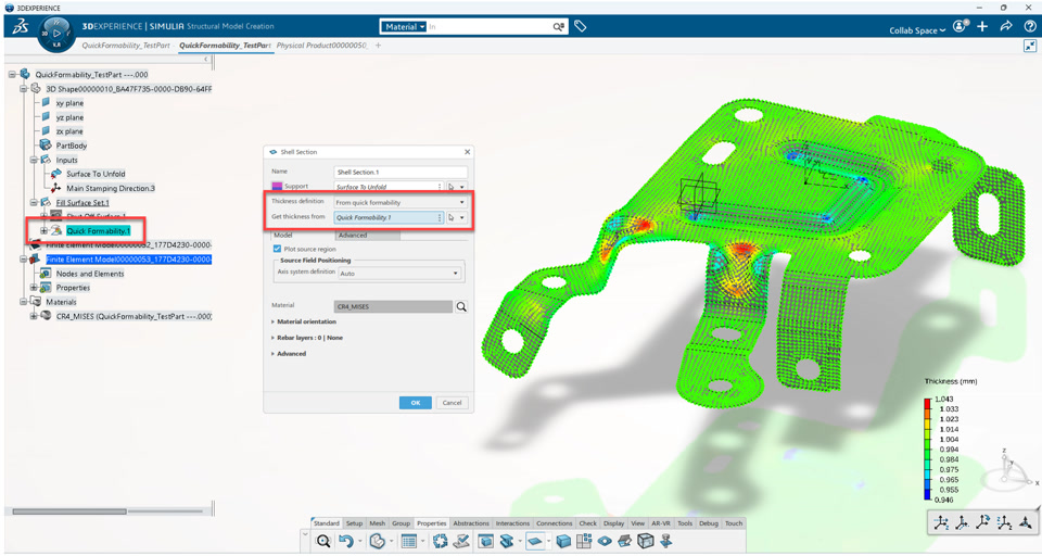

Efficiently create models of formed components using CATIA quick formability feature to initialize shell section thickness

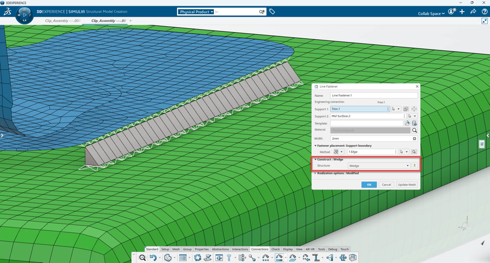

Extend the applicability of line fastener constructs by adding new wedge element options

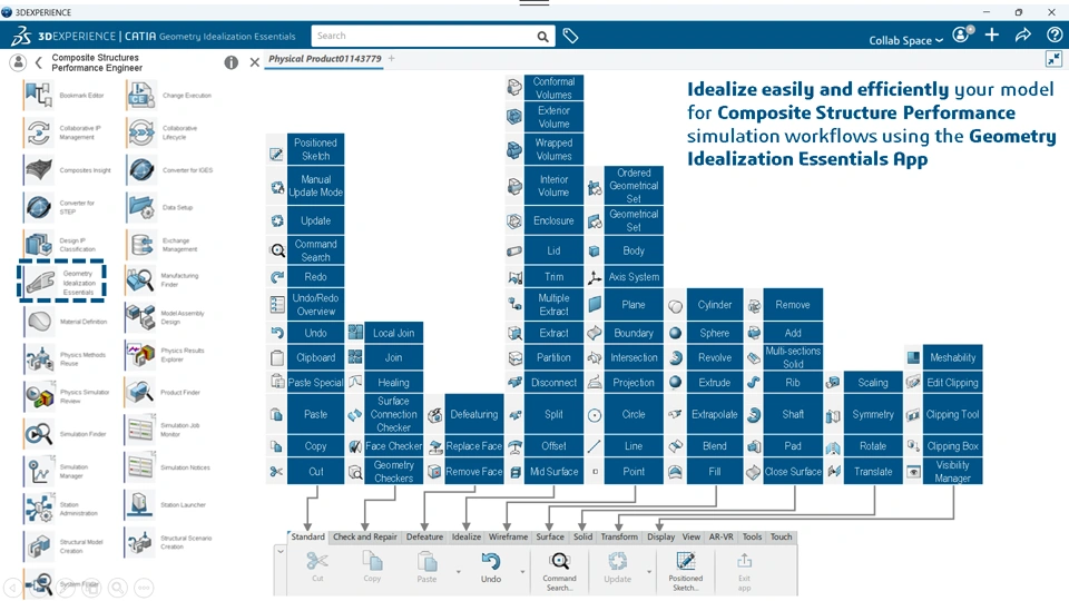

Efficiently create simulation models using new geometric defeaturing and idealization commands with the addition of the new Geometry Idealization Essentials application

Extend line fastener constructs by adding new wedge element option for 'Support boundary', 'Line', and 'Specify Coordinates' placement options
Efficiently create models of formed components using CATIA quick formability feature as initialization for shell sections thickness definition

Efficiently create simulation models using new geometric defeaturing and idealization commands, such as, midsurface generation with the addition of the new Geometry Idealization Essentials application
