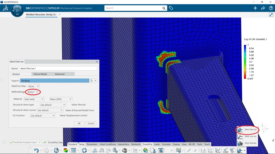

Scenario - Support of the Verity fatigue method for solid element line welds durability assessment

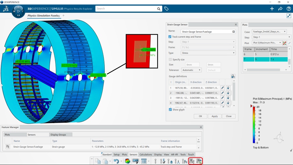

Post-Processing - Virtual Strain Gauge creation tool to define and output simulation results consistent with standard physical test measurement methods, and help determine best strain gauge locations for test

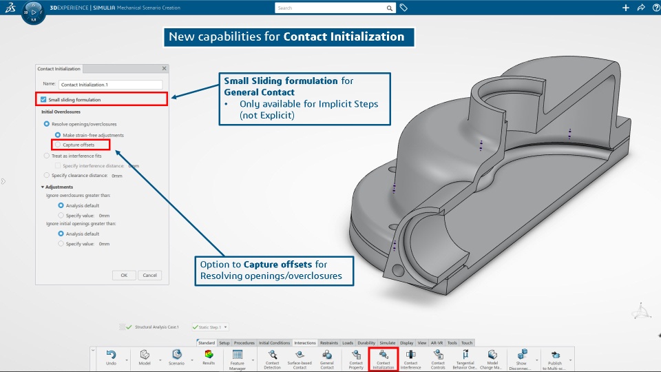

Small sliding in General Contact for faster contact set up in linear cases
Durability - Verity line weld support for solid models
