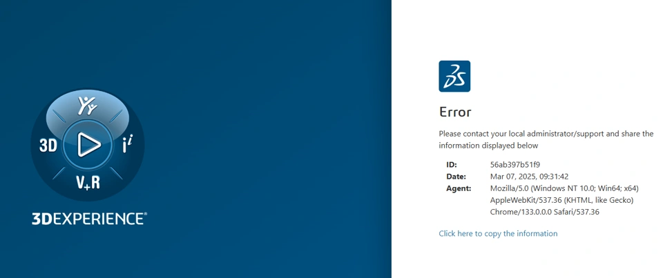

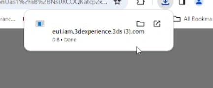

Downloading an empty file when logging in with Authentication Delegation
Probable Cause:
  • It usually means that your SAML Authentication Delegation Setup is incomplete or incorrect. (IdP does not know how to communicate the SAMLResponse back to 3DPassport)
Probable Solution
Follow the instructions detailed in QA00000305710, and make sure your SAML setup is complete.
Pay close attention to:
  • The attributes email and/or username are not provided in the SAML Response.
    • Attribute is not valued on IdP.
    • the attributes defined in your IdP have the same name, with the same case as the field declared in 3DPassport.
  • The ACS (Assertion Consumer Service) URL is not correctly setup

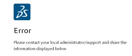

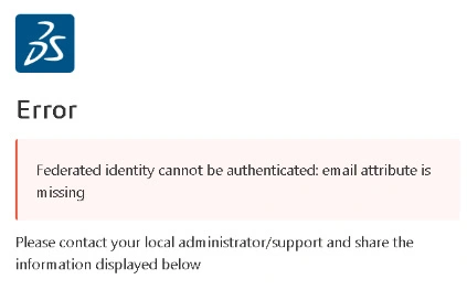

Error: Federated Identity cannot be authenticated: email attribute is missing
Probable Cause:
  • This error message generally means that 3DPassport did not receive any email attribute value or none that 3DPassport could interpret.
Probable Solution:
  1. The solution is to update and make sure the attributes defined in your IdP have the same name, with the same case as the field declared in 3DPassport. (cf QA00000305710)
  2. Make sure the email attribute is valued for the user trying to login on IdP side.In SAML response "email" attribute is missing, Probably because it is not added in IDP.
    Please configure this "email" attribute which is mandatory on IDP side.

Downloading an empty file when logging out with Authentication Delegation
Probable Cause:
  • It usually means that the SLO (Single LogOut) is incomplete or incorrect.
Probable Solution
  • Please make sure to use the SLO binding coming for the 3DPassport SAML Metadata XML, it should look similar to this:
https://r113210****-eu1.iam.3dexperience.3ds.com/saml/<u>SingleLogout</u>/alias/r113210****-eu1.iam.3dexperience.3ds.com

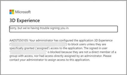

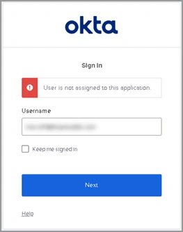

User not able to access the application
Cause:
  • It means that your IdP administrator, has not provided access to the SAML application.
Resolution / Recommendation
  • Reach out to your IdP administrator to request access to the application.
