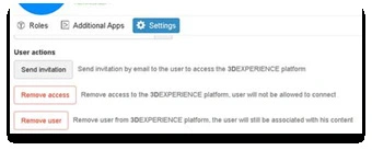

1. Do I have to re-invite Pending users after Activating Delegated Authentication?
YES, there should not be any user in state ‘Pending’ (at invitation in Platform Management / Member & Roles)  before Activating Delegated Authentication.
If any then, un-invite these users from the Platform (“Remove User”),  you will need to invite them again once Delegated Authentication is Activated.

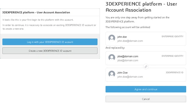

Yes, since 3DEXPERIENCE R2024x FD01, Users can now change the account association:
If they connect with a different external identity, or they choose a 3DEXPERIENCE ID that is already associated to another identity, the user will be able to choose to re-associate its new enterprise identity with their existing 3DEXPERIENCE ID.
Example with a user for which the email address was changed on IdP side from john.doe@domain.com to jdoe@domain.com
