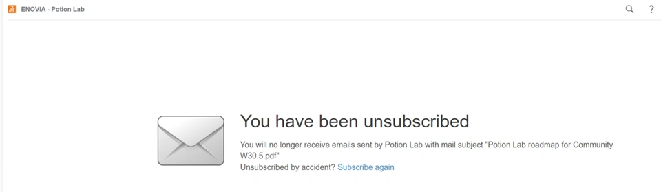

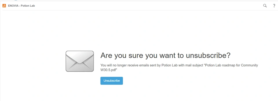

Recipients of emails delivered by potion actions can unsubscribe themselves from individual notifications by clicking the unsubscribe link sent in the notification.
A confirmation message displays with an option to resubscribe.

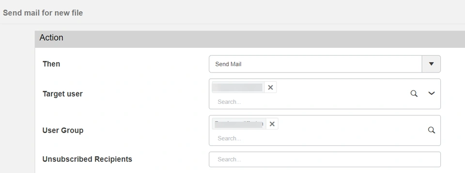

A potion owner can view and edit the list of unsubscribed recipients in the potion Send mail action in the added Unsubscribed Recipients field.

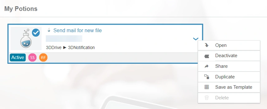

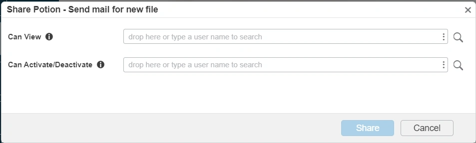

The Members tab is renamed to the Sharing tab in which members are presented in a table and various commands let you work with member permissions, including the ability to share the potion with members.
In addition, you can share a potion directly from a potion tile by using the Share command.
