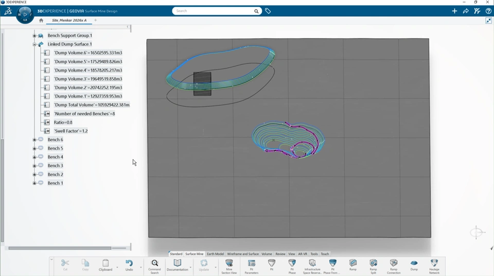

1. Ensure that waste stockpiles meet the needs of the Mine through the ability to link a total Volume to the Design process.

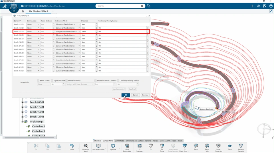

2. Vary ramp parameters by location, enabling different ramp generation depending on localized constraints
3. Improve the practicability of the ramp design by considering flat areas.
4. Enable the mine designer to create the haulage network to run scenario analysis.
The ability to set various ramp parameters for each bench

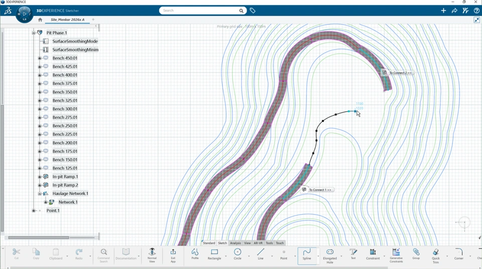

Create the haulage path within the flat area to connect ramps

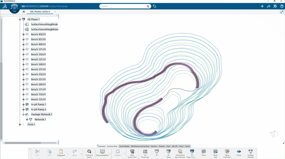

The haulage network of the entire phase design

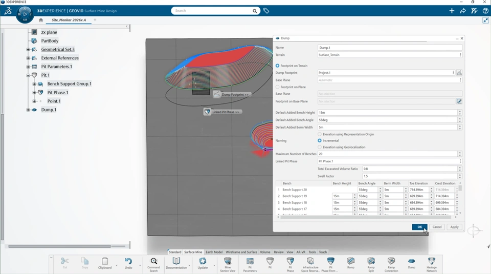

The ability to link the dump design with the phase volume
Control the dump design through the swell factor and the excavated volume ratio
