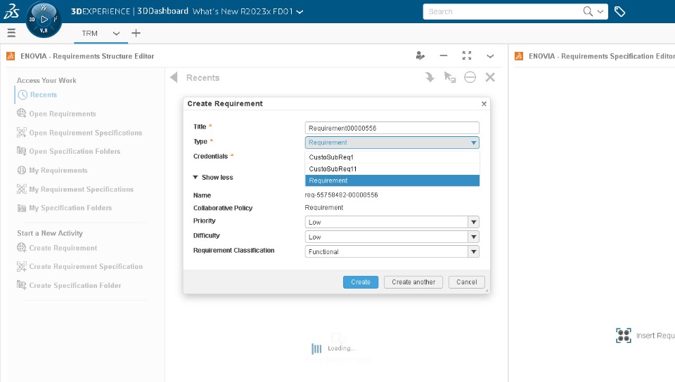

- ability to choose specialized types at object creation

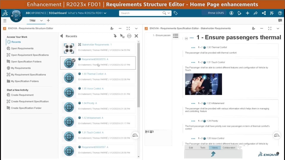

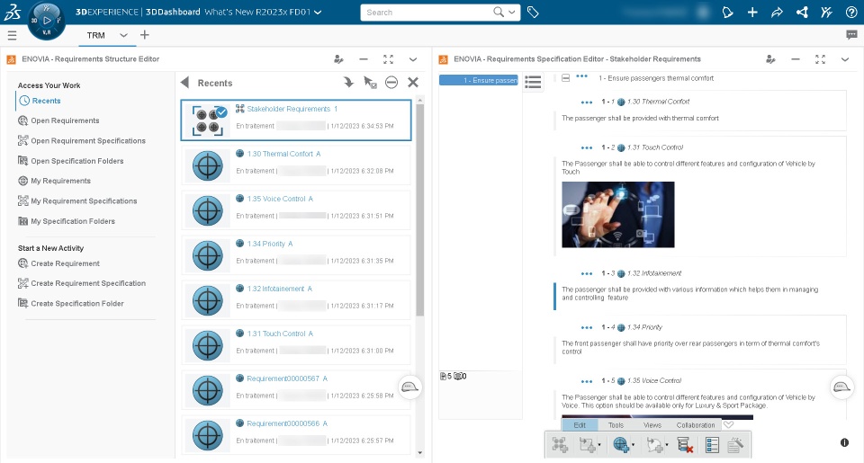

- Speed up performances of the widget
UI Improvement
Home Page Enhancement
User Experience improvement on the Home Page / Specialization of Requirement available at creation
Ability to choose specialized type at creation
Home Page Enhancements / Tile view by default

@AB hello, how the different Requirement types can be created?

@AB can we get an answer please for the above question? These enhance are for cloud. Thanks!

Hello, to do so you need to have administrators credentials to customize the data model and create Specialized Type.
For example, "Enterprise IP Schema Specialization" is a dashboard app that is available on any private or dedicated cloud 3DEXPERIENCE platform to create your own specialization type.

Hello @TP @AB , thanks for the info. But since this info is presented in the "On the Cloud Enhancement" section, I was hoping for some availability for an Ublic On Cloud tenant... it's confusing. Regards
