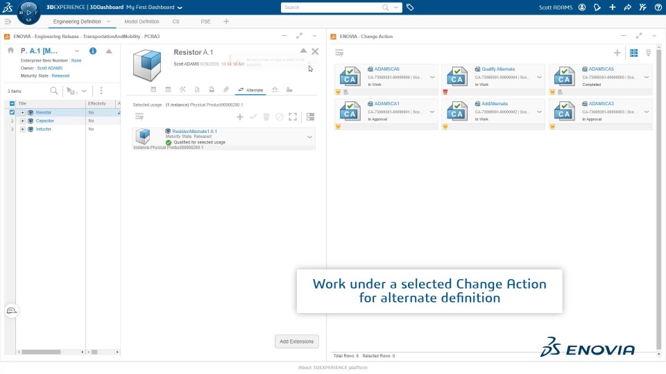

Leverage change management process to define and qualify alternates and substitutes. Streamline the engineering comparison analysis by launching the Compare widget on filtered and non-filtered Engineering Items.

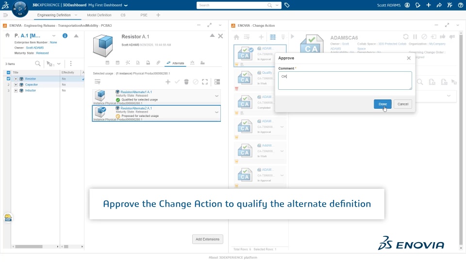

Approve a Change Action to qualify an alternate definition

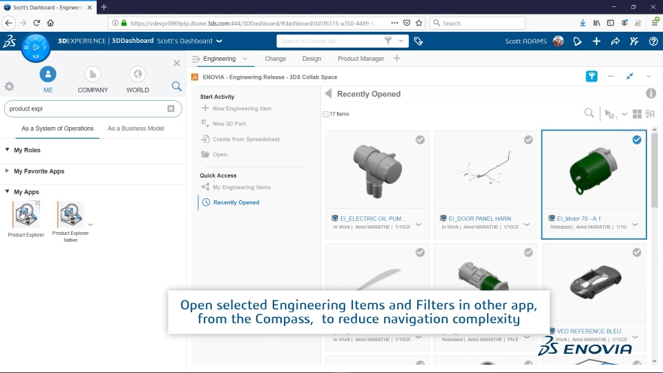

Open Engineering Items or Filters from the Compass to reduce navigation complexity

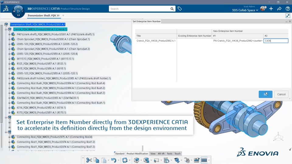

Set Enterprise Item Number directly from 3DEXPERIENCE CATIA to accelerate its definition directly from the design environment

Hi @EH
Thanks for the videos.
I have a quetsion about Enterprise Item Number in 2019x FP2045.
I would like to set an EIN while migrating files from CATIA V5 to 3DX. I have success in mapping the Native and User properties from CATIA to 3DX and saw in the videos that it is possible to set the EIN value directly in CATIA 2021x, but that is something not possible in 2019x.
My question is;  Is there a way (activating by setting a variable to CATEnv or not) to create and edit EIN in a Physical Product during the migration in 2019x?
Thanks.
