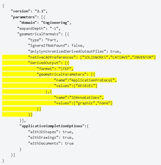

- the mapping support with the EIN during import operations
User Experience Value

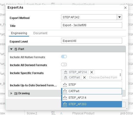

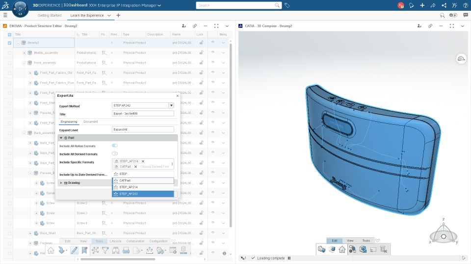

The interactive export experience offer more control while specifying the content. Multiple derived output can now be included to in the exported package if specified by the end user.
Export as STEP command offers more control on which native and derived format to include in the export operation.

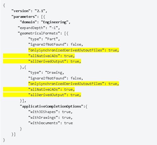

New options are available for the export operation specification: - allDerivedOutput controls the export of all available CAD streams available - allNativeCADs controls the export of all available derived output available - onlySynchronizedDerivedOutoutFiles (Optional) controls the export of derived output that are not synchronized with the source geometry. Its default value is "False"
