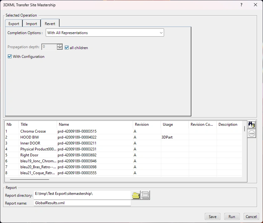

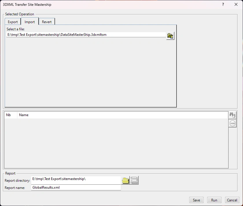

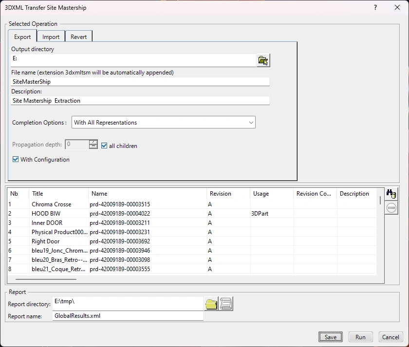

To support data migration scenario, a new batch tool "3dxml Transfer Site Mastership" is introduced to transfer mastership on data from one 3DEXPERIENCE instance to another.
The 3dxml import now support the "As New" mode for X- CAD data. (CATIA V5 and SOLIDWORKS)
The "3dxml Transfer Site Mastership" batch can be used in addition to 3dxml Import as Reference mode to perform the transfer of edition rights from on 3DEXPERIENCE environment to another. It produces a dedicated .3dxmltsm format.
After site mastership export from the source environment, the mastership status is set on data as "MIGRATED" and is not editable anymore. After site mastership import in the destination environment, the mastership status is set on data as it was in the source environment. In case of 3dxmltsm file lose, a "revert" functionality is available to cancel the data mastership transfer in the source environment
