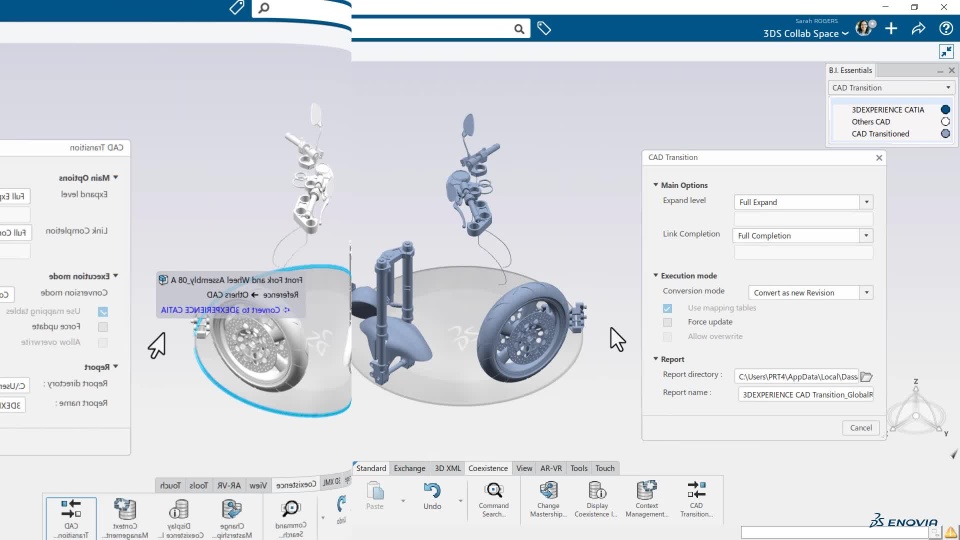

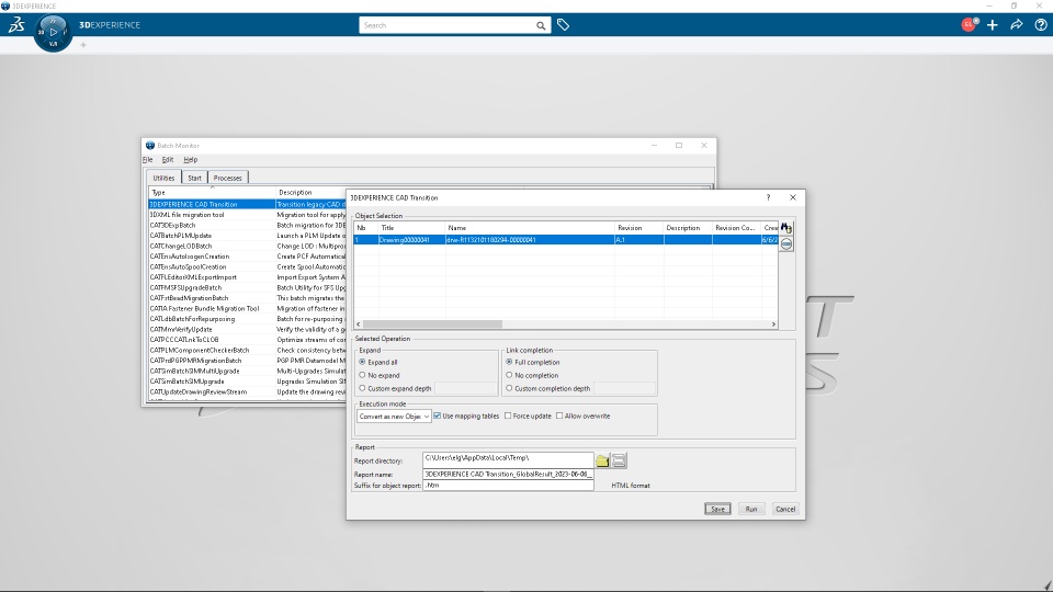

For customers willing to migrate Power'By data to 3DEXPERIENCE at their own pace, a new "3DEXPERIENCE CAD Transition" command is introduced along with new BI to transition interactively their data to 3DEXPERIENCE.

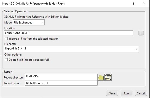

For customers willing to migrate Power'By data to 3DEXPERIENCE at their own pace, a new "3DEXPERIENCE CAD Transition" command is introduced along with new BI to transition interactively their data to 3DEXPERIENCE. The transition process from Power’By towards full 3DEXPERIENCE CAD continues to improves. With R2024x FD01, the enhancement of the transition tool continues with the support of CATIA V5 Materials. With this new PLM Batch, a new import mode is introduced : "Import as Reference with Edition Rights". It addresses the need of populating a 3DEXPERIENCE platform with data authored in another 3DEXPERIENCE platform (master site).
After import, data can be edited on the import site
After initial import, data updates from master site is possible if data not revised on both side. Data is overwritten.
Import of delegated data is not allowed in this mode
Export towards master site is not allowed (at import on matser site)

Hi Adil, Can you share which role do I need to run "Import 3DXml file as reference with edition rights"utility? I have Engineering Data exchange manager role but still could not launch this utility.
Hi Adil,
