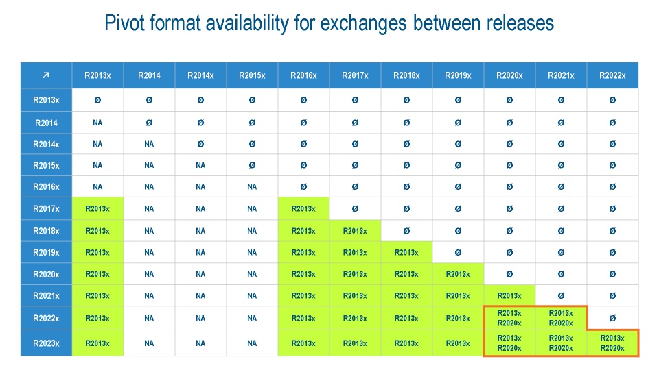

R2020x format is introduced as an option for 3dxml export with compatibility mode. With this enhancement, richer data from latest releases can be exchanged with previous 3DEXPERIENCE Platform releases.
Collaboration and data exchanges from 3EXPERIENCE to CATIA V5 is enhanced for customer with CAA application. In previous releases, Export to V5 process did not support CAA features thus making the operation impossible. With this enhancement, the CAA features are ignored during the export process to CATIA V5. This allow smooth transfer of data from 3DEXPERIENCE towards CATIA V5 for customers of CAA products.
