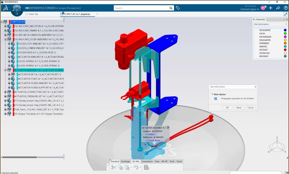

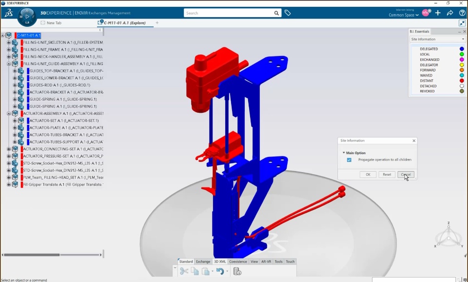

In 3dxml delegation, a new state "Waive Pending" is introduced to better reflect in the supplier environment that the reintegration is pending in the OEM env.
New waive pending status illustration
"Waive" action is available on delegated data only to transfer back site ownership.
Waived status is maintained after export until an acknowledgement is received from the original site.
With the acknowledgement, the ownership on data is changed to "distant".
