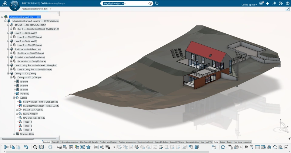

By grouping elements by Storey during the import process in for Design or for Coordination mode, a representation is created that includes one 3D shape per group. Enabling this option also ensures that the terrain is displayed, because tessellated geometries are not supported by the global 3D shape generated under the default behavior (Grouping elements at Site level) .
The Revit Converter preference menu now includes a new option called "Grouping Node." Users can choose to group elements by Site, Building, or Storey. This feature requires the prior selection of "Import for Design" or "Import for Coordination" profile.

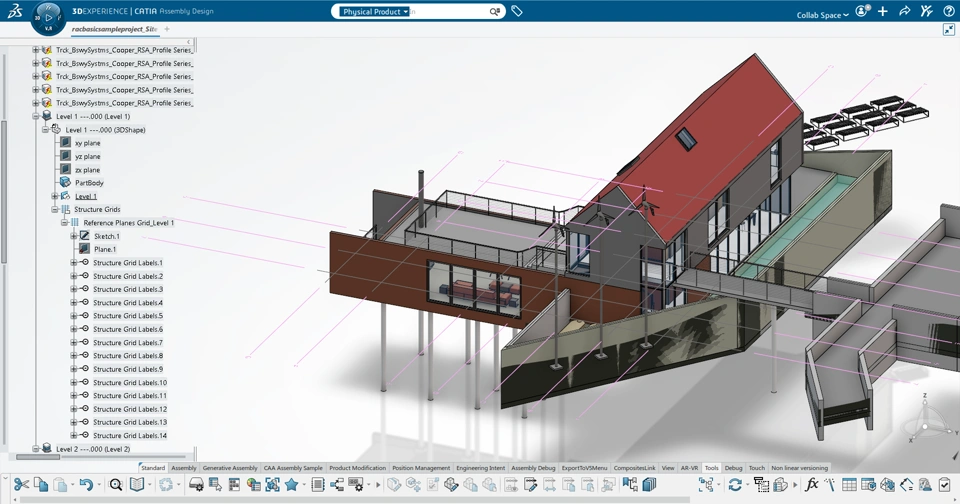

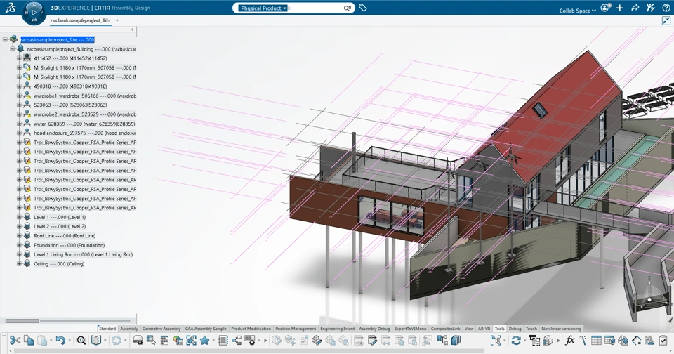

Grids provide a consistent reference framework that facilitates the alignment of models from various sources. The structural grid appears in the imported element tree and is composed of multiple structures, each of which can be set to visible or hidden as needed.
During import, all grids are displayed in the import result. It's particularly valuable when geolocation data is missing.
