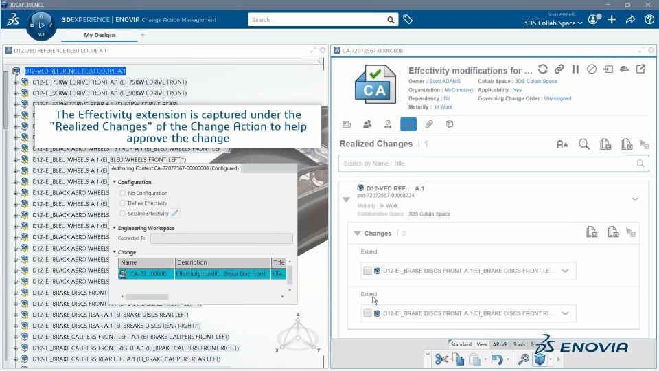

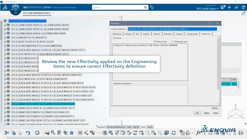

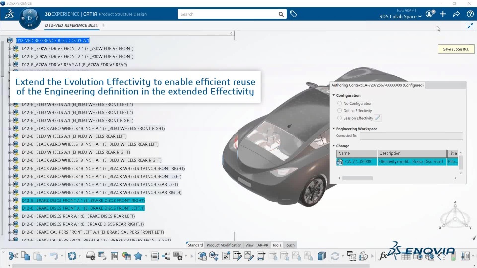

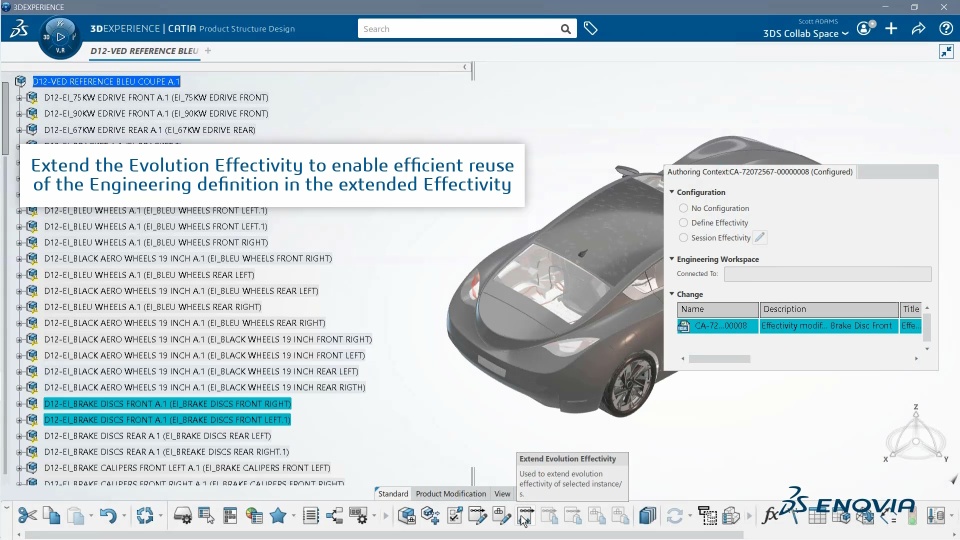

Extend effectivity under change enables massive reuse of existing engineering definition content to initiate the definition of new configurations (e.g. new customer version). The reuse is tracked under change control for traceability and accountability purpose
User Experience Value
Edit effectivity command performance greatly improved (up to a factor 50 on variant effectivity editing in native application)
Extend Effectivity command while working under change with applicability defined
Effectivity is extended accordingly
Realized Changes provide full traceability of extend operations
