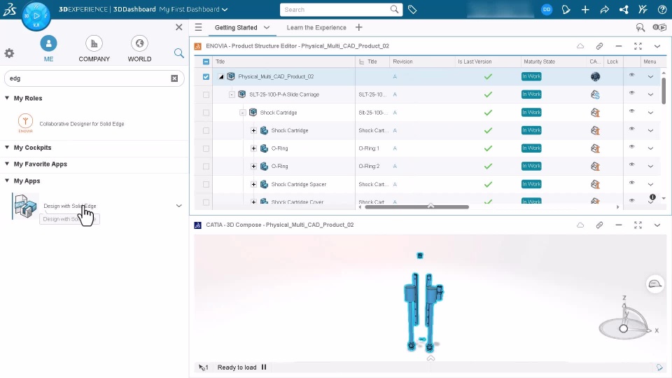

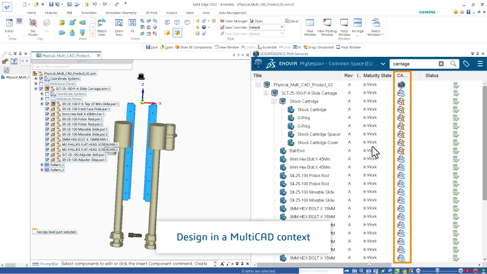

[ENOVIA] Collaborative Designer for Solid Edge

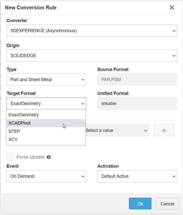

-Asynchronous generation of XCADPivot and STEP formats enables use of Solid Edge data in MultiCAD scenarios

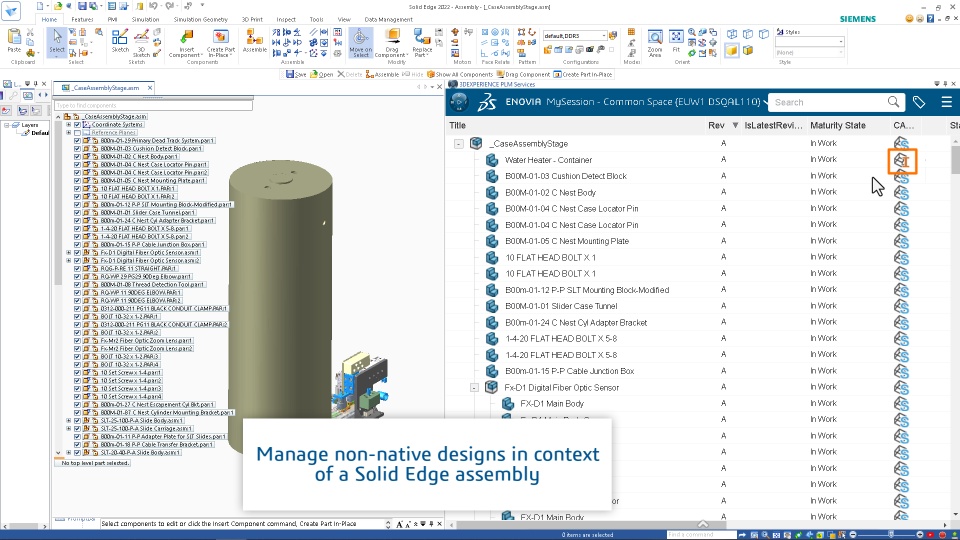

-Standard Part utilization allows companies to manage common parts authored in non-native CAD to be consumed directly in a Solid Edge assembly, this reduces duplicate parts in the enterprise and promotes reuse
-Collaboration is streamlined and productivity is enhanced as MultiCAD strutures consisting of 3DExperience, CATIA V5, Creo, NX, Inventor and SOLIDWORKS designs can be opened in Solid Edge and/or inserted directly under a Solid Edge node allowing the user to make design changes quickly in the context of the entire product structure and eliminates the need for manual preparation
